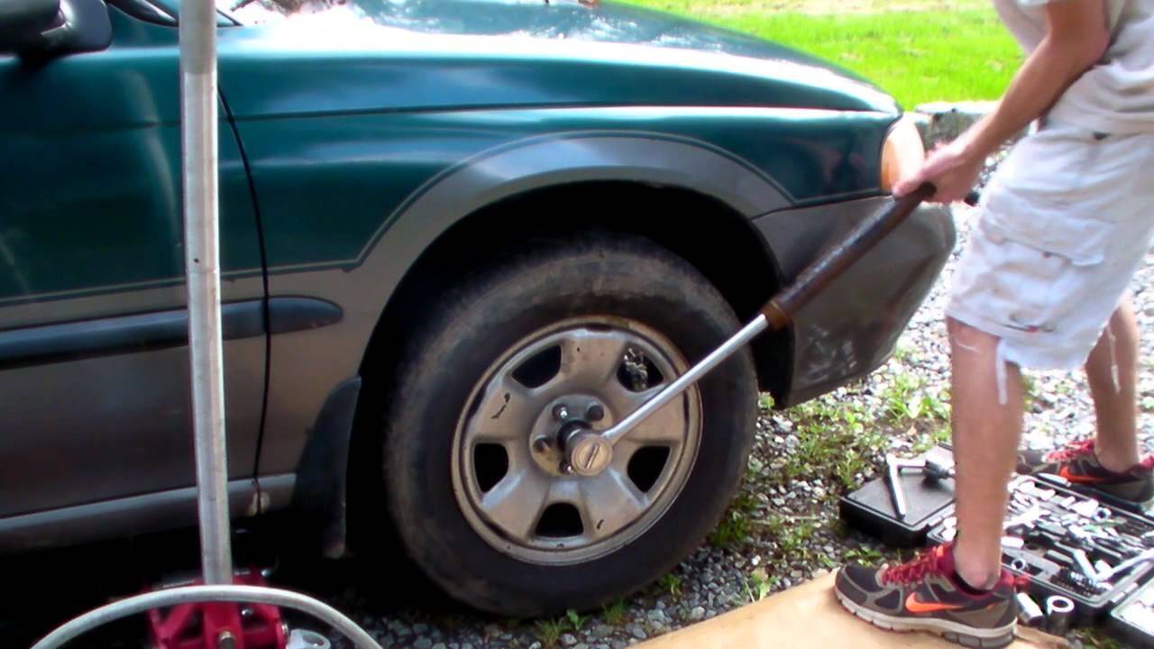

One thing tried before is putting in the spare tire and letting the weight of the wheel on the ground prevent rotation.
You can get to the nut through the center opening.
It's worth a try

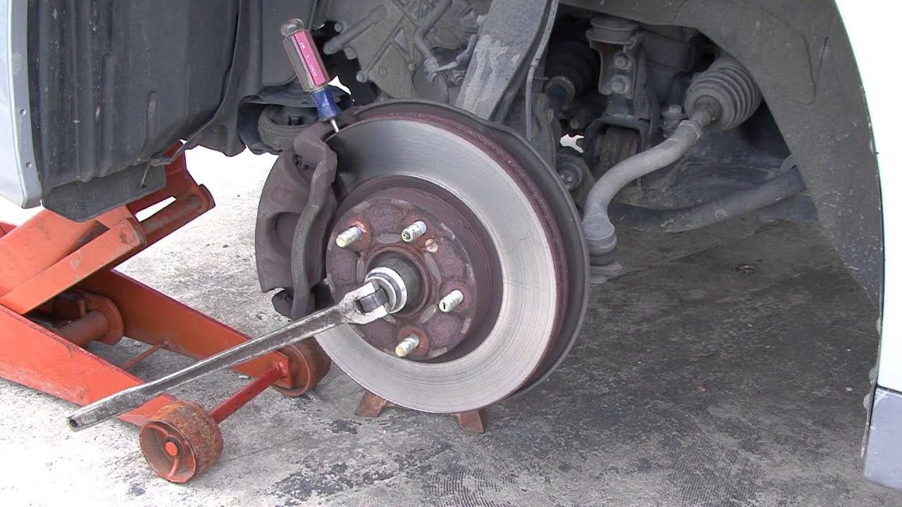

Or the punch or screw driver in the brake rotor to stop the spinning.
Note the Craftsman screw driver at the top of the brake caliper. I know this isn’t an HHR , but the principle is the same. And if you need more leverage , slide a pipe or floor jack handle over the end of the Johnson bar.
Like this guy did.
Like this guy did.
Yeah my socket wasn't deep enough and kept popping off so I didn't want to screw up the nut. My son in law tried to get to it today at the shop but was busy so he is going in early to knock it out before they open. so I should have it back by the afternoon. I did a rear hub on my wifes van in the past, so that's exactly what I did with an old bumper jack bar for leverage.
