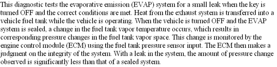

Gas cap, both EVAP valves, pin hole in EVAP tube, loose fitting on gas tank.
Any other symptoms? Hard start etc.
from the shop manual:
