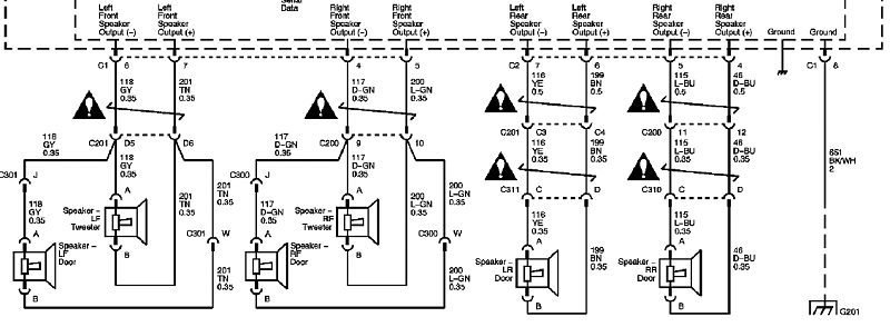

Finally replaced the front door speakers with a couple of good Pioneer 6 1/2", 4 ohm. I'm not sure I got the polarity right. I looked thru the archives and could not find any info on this.
After studying the stock speakers it was hard to tell which wires were positive. I assumed the darker green on the passenger side was positive, the lighter green neg.
On the Driver's side, it looked like the positive was grey.
Anybody know for sure which is which, or have a wiring diagram?

Old Oct 21, 2016 | 12:29 PM
Posts: 26,532
If you can't tell the difference in sound polarity doesn't make any difference.
Old Oct 21, 2016 | 09:06 PM
LVJJJ's Avatar
Joined: 10-13-2013
Posts: 101
From: Blaine WA
thanks donbrew. I see I do have the polarity reversed. I may even have them out of phase so I'll have to get back in there. The reason I'm concerned is that the left speaker is not as loud as the right. Also worried that with these delicate radios these days that the head may not like the way I've got it wired.

Old Oct 27, 2016 | 09:15 AM
LVJJJ's Avatar
Joined: 10-13-2013
Posts: 101
From: Blaine WA
my take on donbrew's comment was that if both were hooked up "wrong", but with the same polarity then it would be ok. That's the way I have it now. I guessed wrong which car wire was positive on both sides. Luckily I guessed wrong on both sides. If I'd got one right and the other wrong, then they would be out of phase. I couldn't find any markings on the stock speakers so had to guess.
I am going to get back in there and hook them up right, according to the wiring schematic provided by donbrew. Now I just have to wait for a sunny day, very rare where in Pacific NW. We've had over 6" of rain this month, about twice as much as normal.
