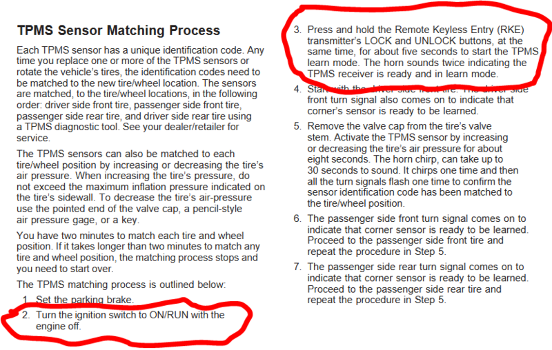

The TPMS reset procedure should work if the lock buttons work. Step #2 & #3 are important. Key ON/engine OFF.
Have you tried the remote start? If your fob does not have a button for it "lock + panic" does the same thing. Look for AP3 on the glove box door.

I just came back in from trying it again since the rear upper brake lights and battery were replaced yesterday. The horn never beeped to indicate that it is in learn mode.
