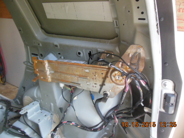

Gutting the Interior, up to the Dash
The first photo is the progress so far. All of the interior, plastic panels, seats, carpets, console, have been removed. We're keeping the wiring in place for a few more days. We are thinking that marking the floor boards where the wiring is routed and take photos, might be handy later during re-installation..

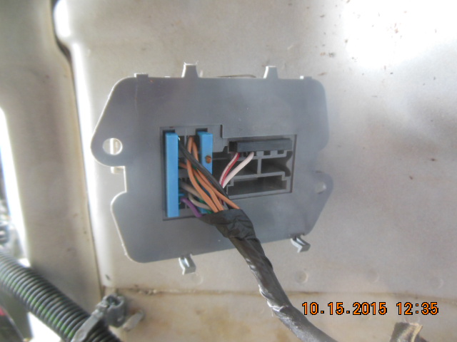

The second photo is the passenger side of the very rear cargo area. This shows the GPS & Cell Phone module & wiring. Note that the mounting plate is not painted. I'm going to gut these out of my HHR Panel Daily Driver, just more junk that I never use..

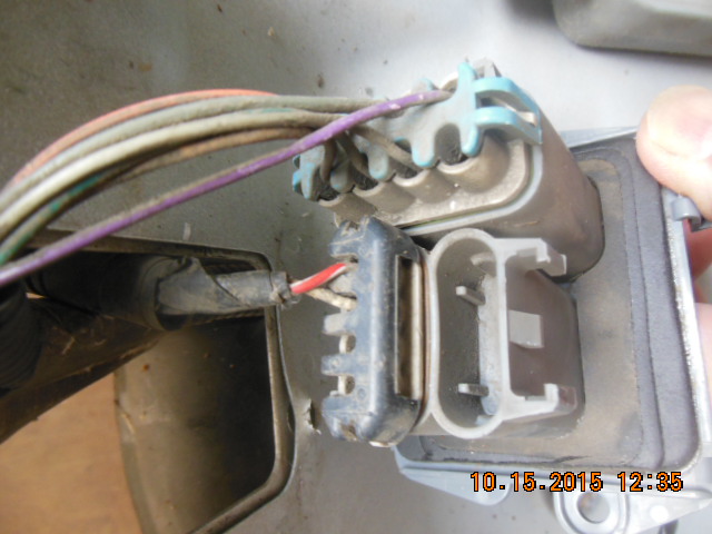

The third & forth are the fuel tank connectors. We were extra careful not to damage this connector. The fuel tank will be removed and a new tank installed in very rear of the cargo area. We will probably re-use this connectors and mounting bracket. Unfortunately the fuel tank on this donor is nearly full and needs to be emptied asap...

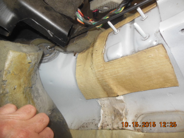

The next photo #5 is on the drivers side just forward of the console. This area on both sides will need to be widened for the transmission. Getting anxious to find out How Much Cutting. We're planning to fabricate a fiberglass Removable cover.

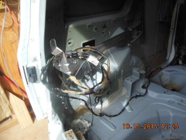

Photo 6 is a glob of wiring on the rear cargo area on the drivers side. It glued to the top of the head liner. It starts in the front of the car on the floor boards, and is routed to the cargo area, then onto the headliner - ceiling light then forward. The cargo lamp has two magnets to hold it in place....
The interior gutting takes a lot of time. I wore glove as there are a lot of sharp edges everywhere. The seats are bolted with two bolts on the back supports. To remove just lift up the rear of the seat and push forward. And unplug the wiring.. The Carpets need to be folded on the corners to get them under the bracing bar.
