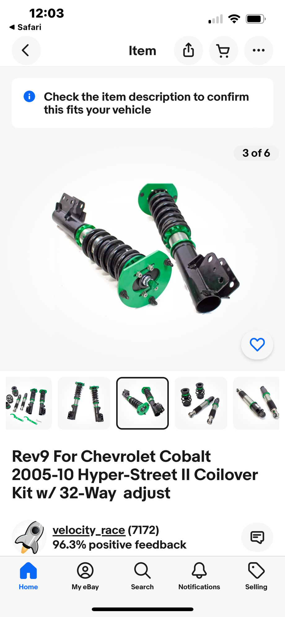

Hello new to forum. I have 2011 HHR LT 4 - Door Wagon. I noticed it says LL on title. Curious about that. But main concern I am gonna install Rev 9 coilovers front and rear. I need to know what else do I replace on front end like sway bar link size? If I am missing something please let me know.. I have already read all reviews on Rev 9 coilovers.They will be fine for what I am doing. If you know any of the shelf parts to resolve my cast and camber issues.

The stock swaybar end links should be good, steering rack spacers and rear transmission mount spacers from ZZP or Turbo Tech Racing will help as will camber bolts if required.

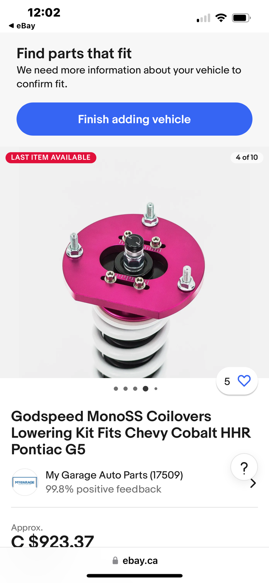

There are upper strut plates with adjustment for camber and caster, your kit might have them
Old May 5, 2024 | 11:04 AM
Posts: 40,082
I should have looked those up
Old May 5, 2024 | 01:35 PM
Posts: 26,532
Those appear to have camber and caster adjustments
Old May 5, 2024 | 04:14 PM
Posts: 40,082
As I said…
Old May 5, 2024 | 04:47 PM
Posts: 26,532
I'm having a bad eye day. Didn't see any text at all.
Old May 5, 2024 | 05:56 PM
Posts: 11,721
So. Looking at those adjustable strut plates, they can only be used for caster adjustments ? You would still need offset camber bolts as Donbrew mentioned ?
