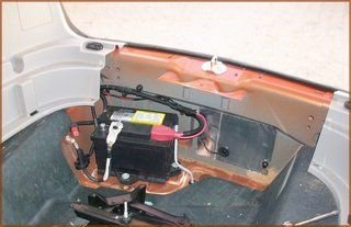

When I installed my trailer hitch, I installed the plug and play Curt harness, I popped out the plastic piece over the battery and the two little access doors. I drilled one small hole for the ground wire on the driver’s side with the self tapping bolt I used. Quick, simple and those OEM wires are so thin, I didn’t want to cut a splice into them . I use the trailer hitch for our bicycles on a rack, never have towed with it, but I can if need be.
Where the plastic panel was above the battery. This is not one of my HHR’s, it’s an Internet sourced photo
and here is a how to from this site
https://www.chevyhhr.net/forums/how-...-wiring-32903/
Yep, super simple and no damaging of existing wiring.

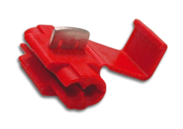

I will say that I did try the 3M tap splicers , red ones came with resistors for LED lights, those cut right through the tiny wee flimsy wires. I don’t recommend them at all
These little thingys, called Scotchloks , great idea, the blue ones are to big for the HHR’s thin wires, the red ones are to small.
