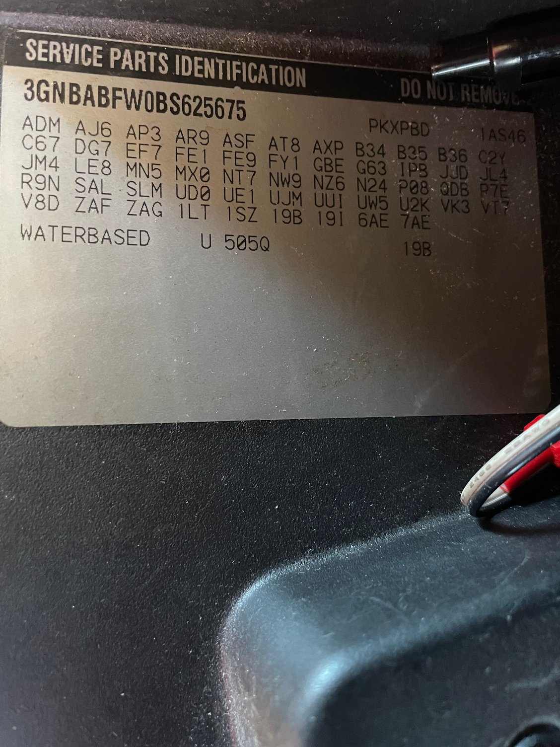

Ok, thanks. Kind of like to keep final drive as close to same as possible. Mpg is big thing for me.

Originally Posted by donbrew
I GoOgled "hhr final drive ratio" and goy a lot of info.
looks like mine has FY1…
Here it is
Here it is
Old Jan 18, 2026 | 10:53 AM
Posts: 40,082
That’ll do you just fine!

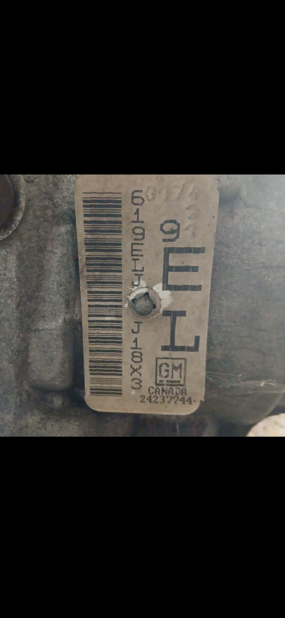

This one is one the guy has….if I am reading the ID tag correctly this made in 09 and it is ELJ code? Now I just need info on that code if anyone knows where I can find that.
No that is not right….2011, 9EL

I havent found anything on a 9EL as of yet.
