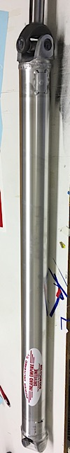

Driveshaft Complete
I picked up my new driveshaft from Inland Driveline yesterday. They sell thru Summit Racing but they are only 12 miles from where I work so I just went there and ordered it.. it's rated for +650 hp so it will be as strong as the rest of the driveline. I'll install it this weekend.
