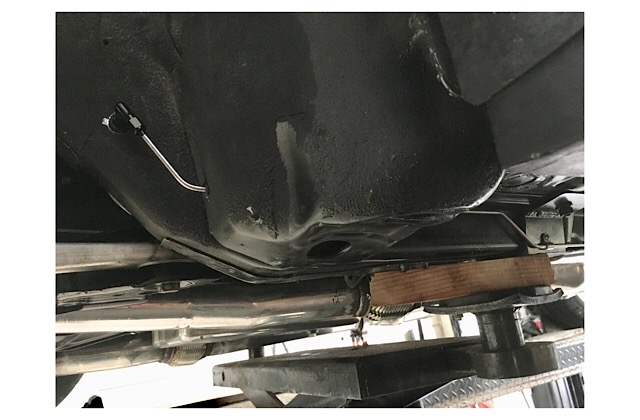

Update
Wanted to give you guys an update on my progress. Work is proceeding on a bunch of changes. Now that the build is nearing completion I’m finding several major things that aren’t just right. Some time ago I realized the Camaro rear axle wasn’t going to be strong enough to handle the horsepower that I’ll be feeding it. To this end, I replaced it with a Currie 9 inch posi unit. That was completed a couple of months ago. Fortunately I got a second chance to make a couple of minor tweaks for some clearance issues I had with the panhard bar and the rear air shocks. The air suspension moves so much up and down it really created some unique “challenges”. Another item that needed to be replaced was the stainless brake lines running to the rear. The location of the cats was way too close to the brake lines so I had to re-route them outboard to the side of the sub frame. The next item in the list is to split the rear line to the rear Wilwood calipers. Here is a picture of the stainless line and the -3 AN fittings.
