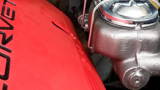

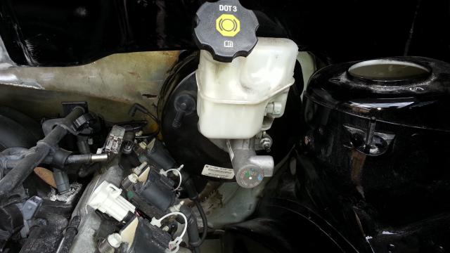

Trouble in Paradise
After moving the master cylinder as far over as it would go I put the engine back in the car and guess what? It hits the engine. Damn! I went back to the pics I have of the YearOne build and guess what? They used a Hydroboost master cylinder. What is a Hydroboost you ask? I never heard of them before today but with lots of internet searches, this is the way to go. It uses the hydraulics from the power steering pump to power the brakes and does not have that huge vacuum can associated with power brakes. Bingo! I think I'll find a unit out of an Astro Van or a Mustang from a bone yard. I'll look next week.

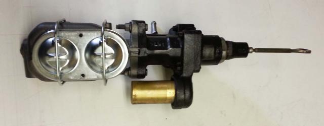

In my quest for a brake system that will fit in the limited room I have between the left head and the strut tower, I went with a Hydroboost system. After researching it a bunch I settled on a Hydroboost unit out of a '98 Chevy Astro Van (Ugg!) mated up to a master cylinder out of a "78 Corvette (Yea!) Some things just shouldn't be done. Anyway, it looks like everything will be fine and it should fit. I'll see this week-end.

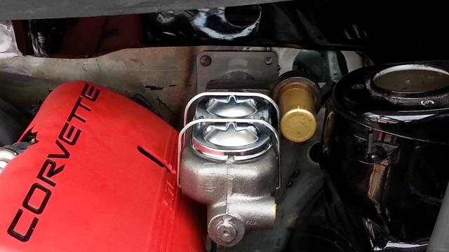

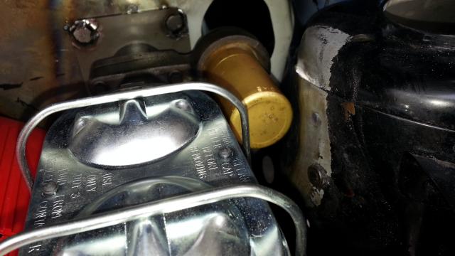

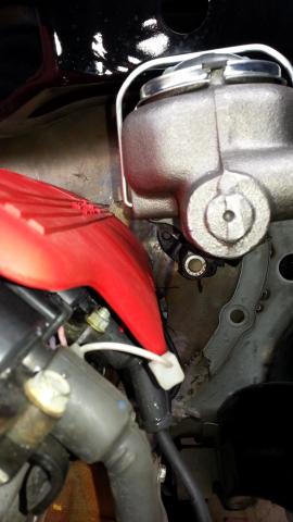

I'm doing a mock-up of the Hydroboost and master cylinder and it looks like it will fit. I need to go back and weld up some holes I put in the firewall for the other system. I need to move the steering hole too, it hits the header.

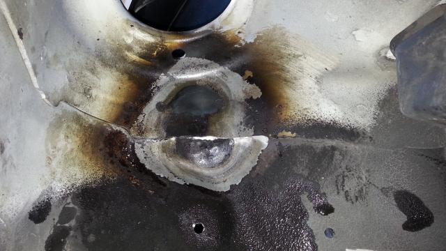

Master Cylinder In
OK so I spent an entire day on the brake pedal/hydroboost/master cylinder and it is finally in. I had to adapt the HHR brake pedal assembly to the wider and taller hydroboost bracket. Then I moved the firewall mounting holes about 1/4" to the outboard side. Once I did that, the high pressure actuator on the hydroboost hit the drivers side strut tower......of course it did. Soooo, time for the torch to heat the tower bright orange and take a 3 lb. hammer and beat the crap out of it. Put a nice dimple in it so it all clears now. The first picture is inside the driver front wheel well looking up at the place I heated and beat in the strut tower. That is some seriously thick metal it there.
