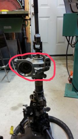

I Got A Plan
As I said before, the brake pedal and the steering colum are both in the same place. Since I can't move the colum over any here is what I'm gonna do. First I need to completly re make the brake pedal and pedal hanging assembly. It will be a flipped version of stock with an offset pedal arm so the pedal itself ends up in roughly the correct place. To get the steering colum thru, I will remove the motor assist casting (circled in red) which will make it small enough to get by the pedal arm. I will have to build a new pivot point that will go in the same place as the old one but it will not have the bulk of the existing casting. This will probably take me a few weeks to do so I probably won't be posting much for a while. I'll keep ya posted.
