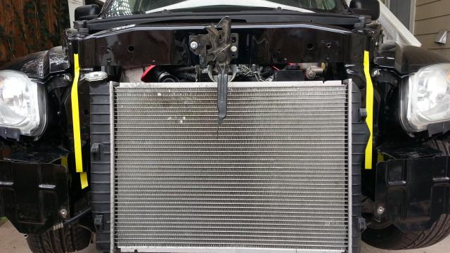

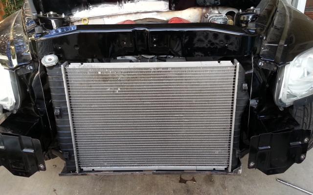

I have the radiator mocked up in the new hole I cut in the front. It fits well, I have to fab and weld in some new sheet metal pieces for the sides and then I have to duplicate the lower radiator mount on the Camaro. Should be easy, just take some time. I'm glad this setup worked, I really didn't want to buy an aftermarket cooling system. Big bucks.

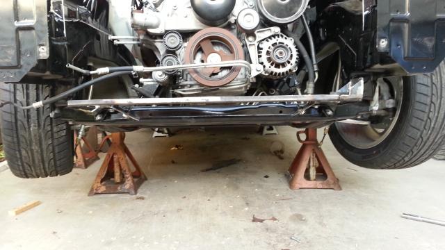

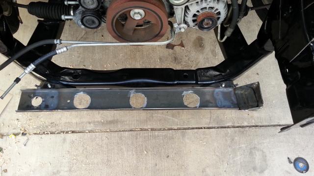

More Radiator Install
Spent the day building the lower radiator mount. I took a left over piece of 2x3 rectangle tube (from the sub-frame) put it on the band saw and made it 5/8 x 3. Made some extensions for the HHR radiator mounts off the engine cradle and welded it together. The driver side is complete because I had the Camaro rubber lower mount for that side. I left the passenger side long because I'll have to get that rubber lower mount from my Chevy dealer. At the same time I'll order the upper rubber mounts and adapt them to the top. The very best news about using the Camaro cooling system (besides 1. the cost and 2. I know it will work just fine) is that all the stock Camaro radiator hoses and the trans cooling lines will fit! ....I have enough design and build items on my plate.
Old Mar 23, 2014 | 01:10 AM
  #164
Lucky's Avatar
Joined: 12-24-2007
Posts: 2,873
From: Seville. OH
I'm impressed. It looks almost factory.
