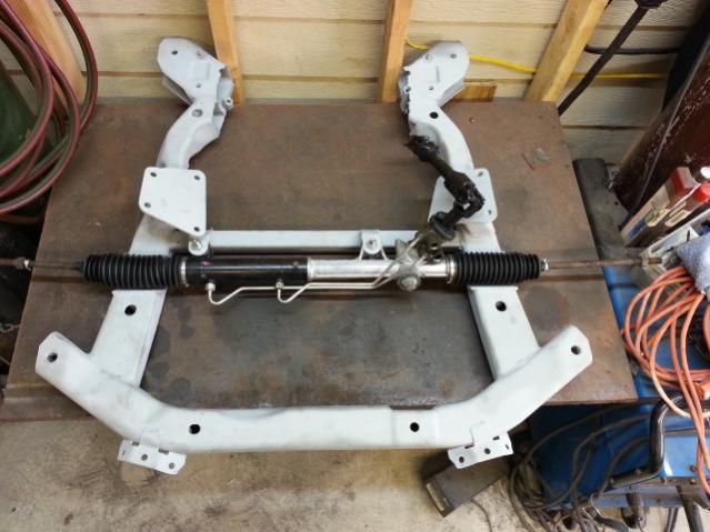

Steering rack
Originally Posted by prod
One question, what steering gear are you using, from the camaro or the hhr? I forget which was which, but each of those V8 builds used a different setup.
I'm using the Camaro rack. I duplicated the YearOne steering as close as I could. I looked all over for a "front steer" electric rack that would work but I never found one with everything I needed. It would be cool to keep the HHR steering motor so I wouldn't need a power steering pump, hoses & belt but no luck.
I have never seen ANY helpful pictures of the Unique HHR other than with the hood up and that beautiful blown motor sitting there. If you know of any "build" photos of the car, please post them.

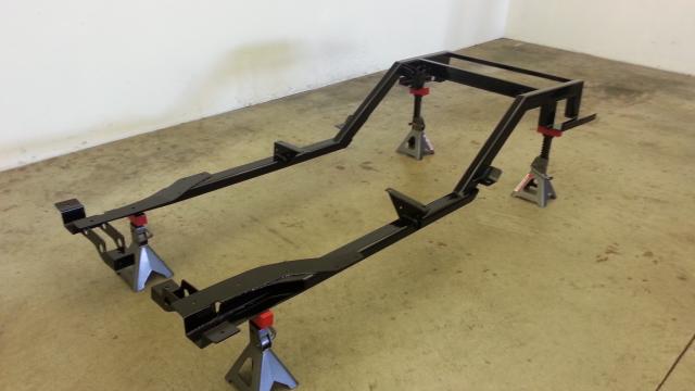

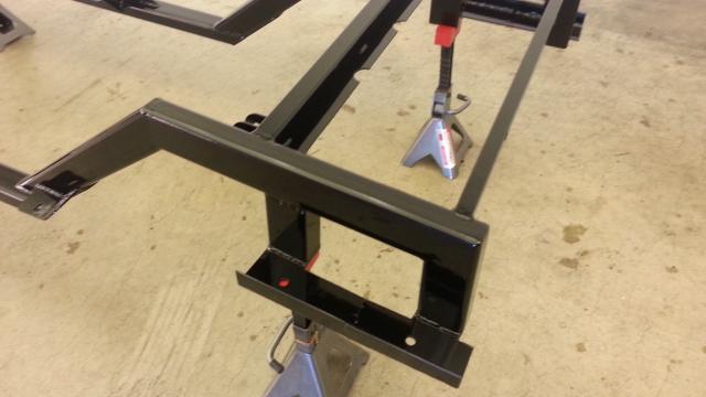

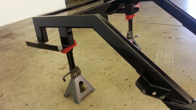

Sub Frame Details

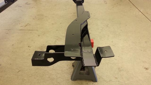

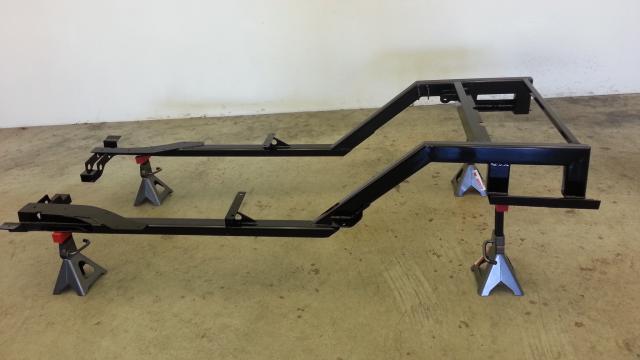

Well here it is boys and girls. The complete sub frame ready for install. Got it back from powder coat and hope to begin final install next week. For anyone that is interested going down the same path I took, you can use these pics as a reference. The only way I know to build another one of these is on a car body...lots of strange angles that you just need to see with your own eyes to make it. But it's not that difficult. I think a monkey could do this.
It's built mainly out of 2"x3"x 3/16" rectangle tubing. the brackets are mainly 3/16" plate. A few brackets in the transmission cross-member area are 1/4"

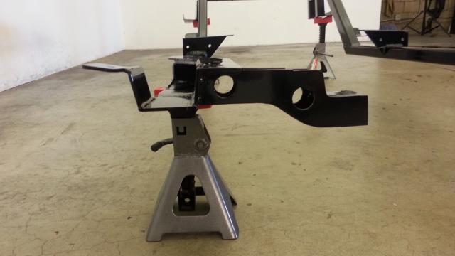

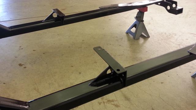

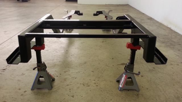

Sub Frame Details 2
More Pics

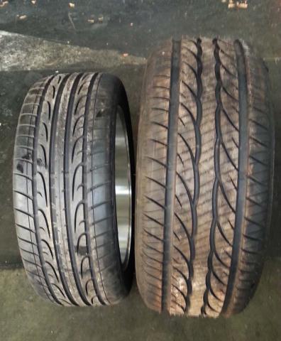

Believe it or not, today is the first time I set the front and rear tires along side each other for comparison. As you can see, there will be a lot of rubber under the rear end of this car.
245/45/17 vs. 275/55/17
