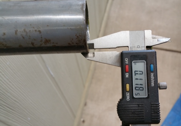

I have seen the tubing he is making the roll cage from and it looks like the electrical conduit we used to pull wire through at work to me.
Looks puny to my mind.
I know he doesn't plan to crash his buggy and that it is not required by any state to have on in your vehicle,... its just me I guess.
As a retired journeyman electrician (26 years IBEW Local 440) I can assure you that this tubing is not EMT. EMT measures .039" wall. That's why it's called 'thin wall'. Although I'm not necessarily building this cage for drag racing, I am using the NHRA rule book for the specs. They require 1 3/4 x .118 tubing, welded to 6 x 6 x 1/8" plates welded to the chassis. I am doing all of that. Since I'm not going to race it on a regular basis, I'm not concerned about passing a tech inspection. However, it probably will pass.

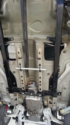

Are you or did join the two sub frames? back in the 60s I watched Dick Landy burn out and the body flexed. It broke every window in the Car!! He did not join the sub frames.
bluwing
I seriously doubt that I will be putting down the horsepower that "Dandy Dick Landy" did, but I am sandwiching the body floor between 2 pieces of 1/8" plate held together with grade 8- 3/8" bolts and nyloc nuts. I've done this in about every place that is possible.

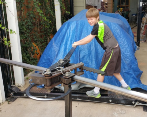

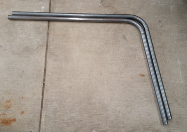

Never too young to learn
My 12 year old grandson Chase came over to help me today. He loves physics and what better way to learn it than bending tube? He catches on fast. We are bending the left and right rear pieces. This is the best way to work on something.
