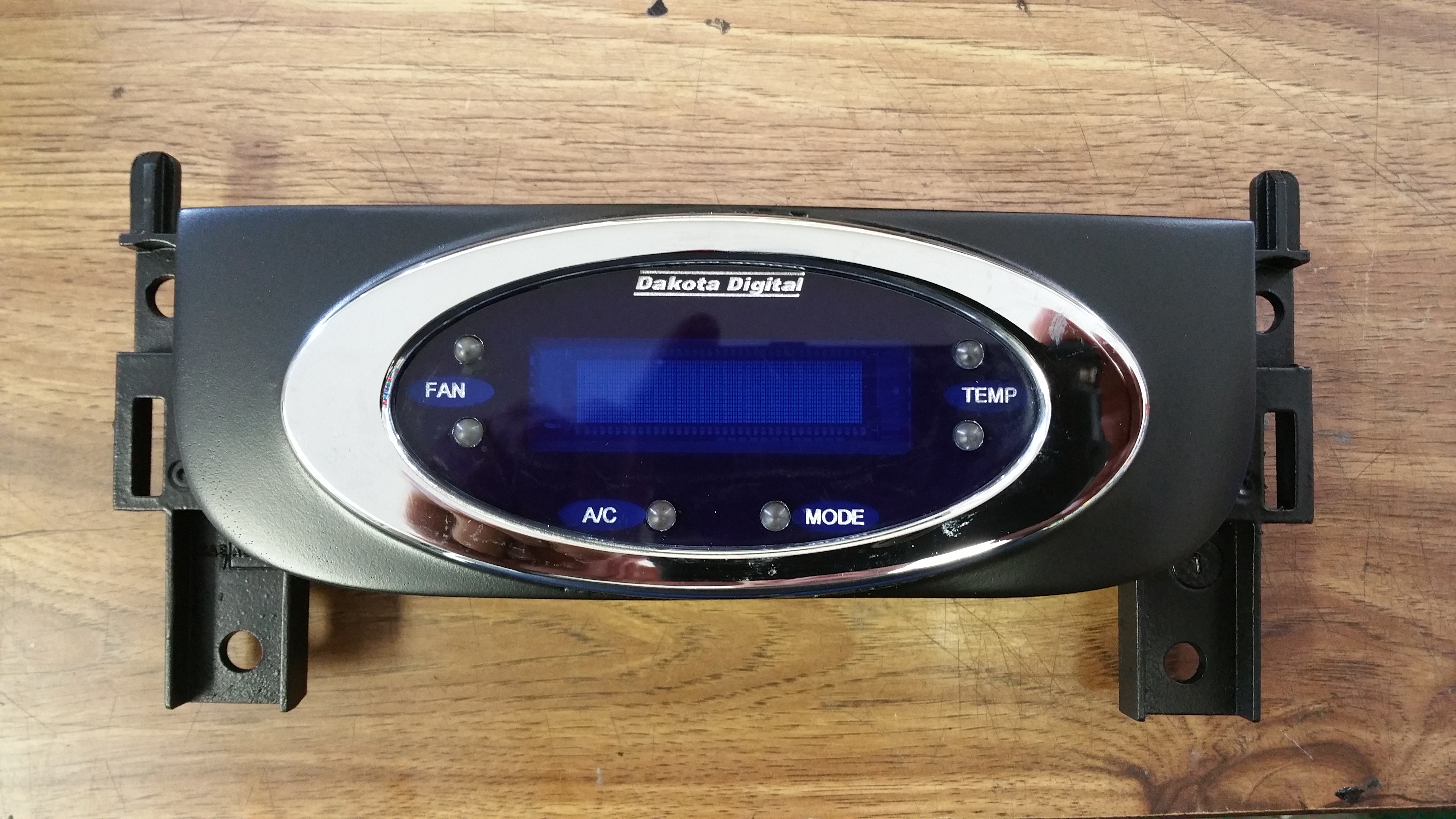

Follow Up to A/C Controls
After literally 10 hours of work the A/C control panel is ready to install. This should look pretty much factory.

Old Aug 6, 2015 | 06:43 PM
  #603
Posts: 40,083
Pure artwork!!

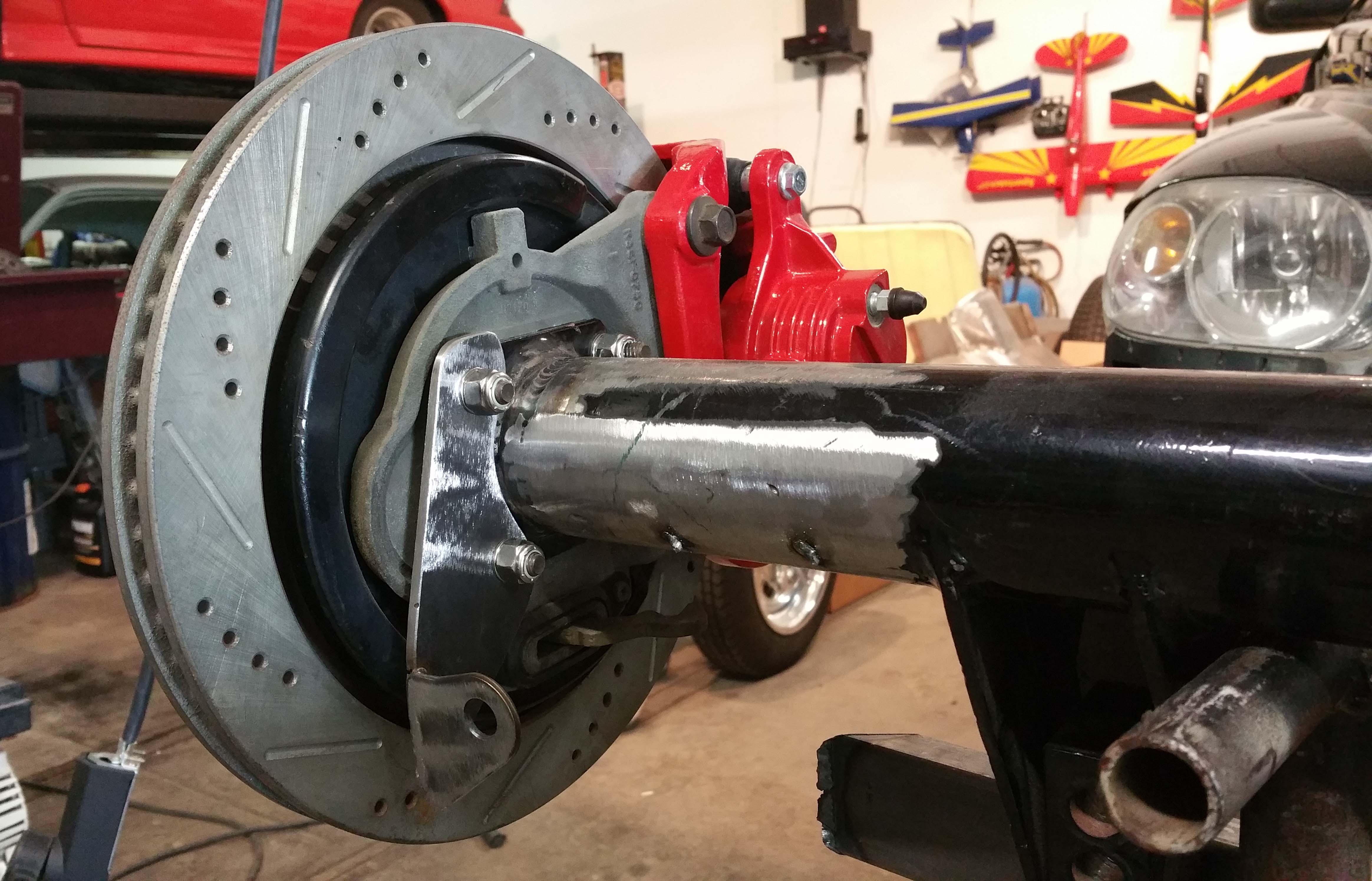

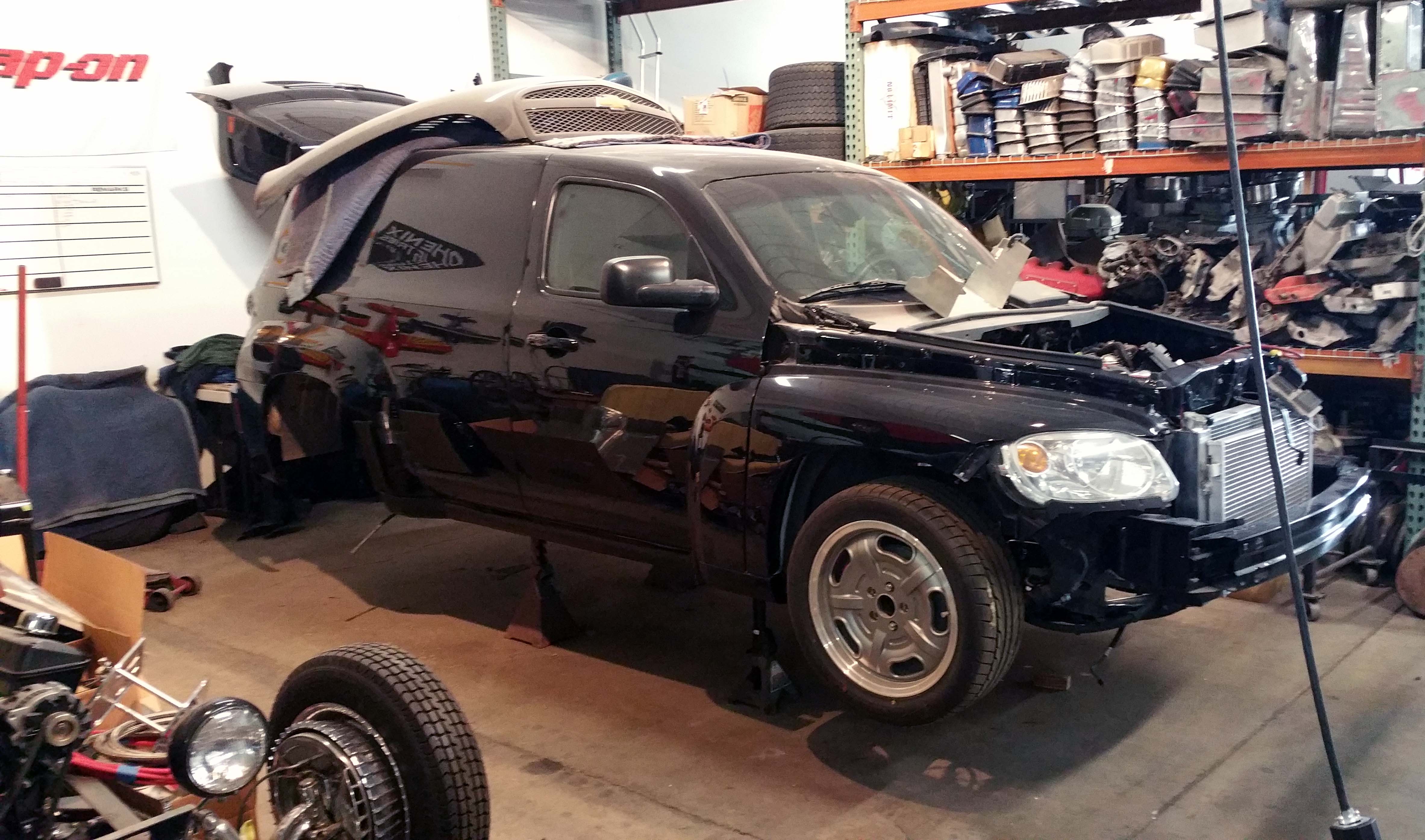

Update
The rear axle is out of the car again and some final brackets/tabs are being installed. Here is a shot of the e-brake cable brackets. Dirt simple but no reason to make them more complicated. As you may recall, these Camaro brakes are swapped side for side to get the lever to pull forward. So you are looking at a left rear brake mounted on the right side.
