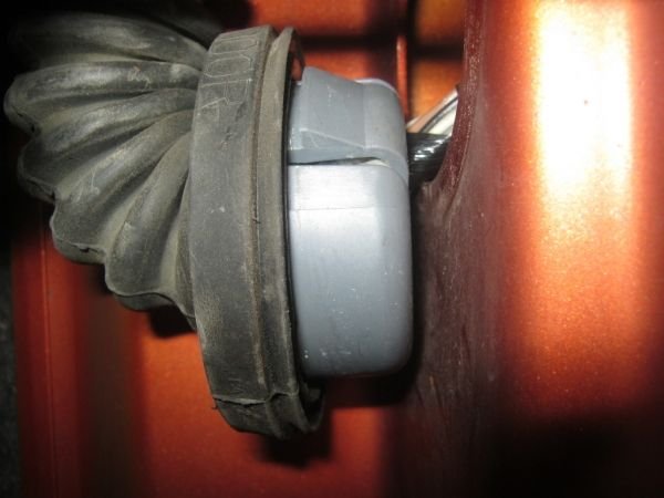

Look at those make sure they are seated into place , have a look at the wiring boots and make sure they are sealed properly
Make sure this boot is sealed against the body.
