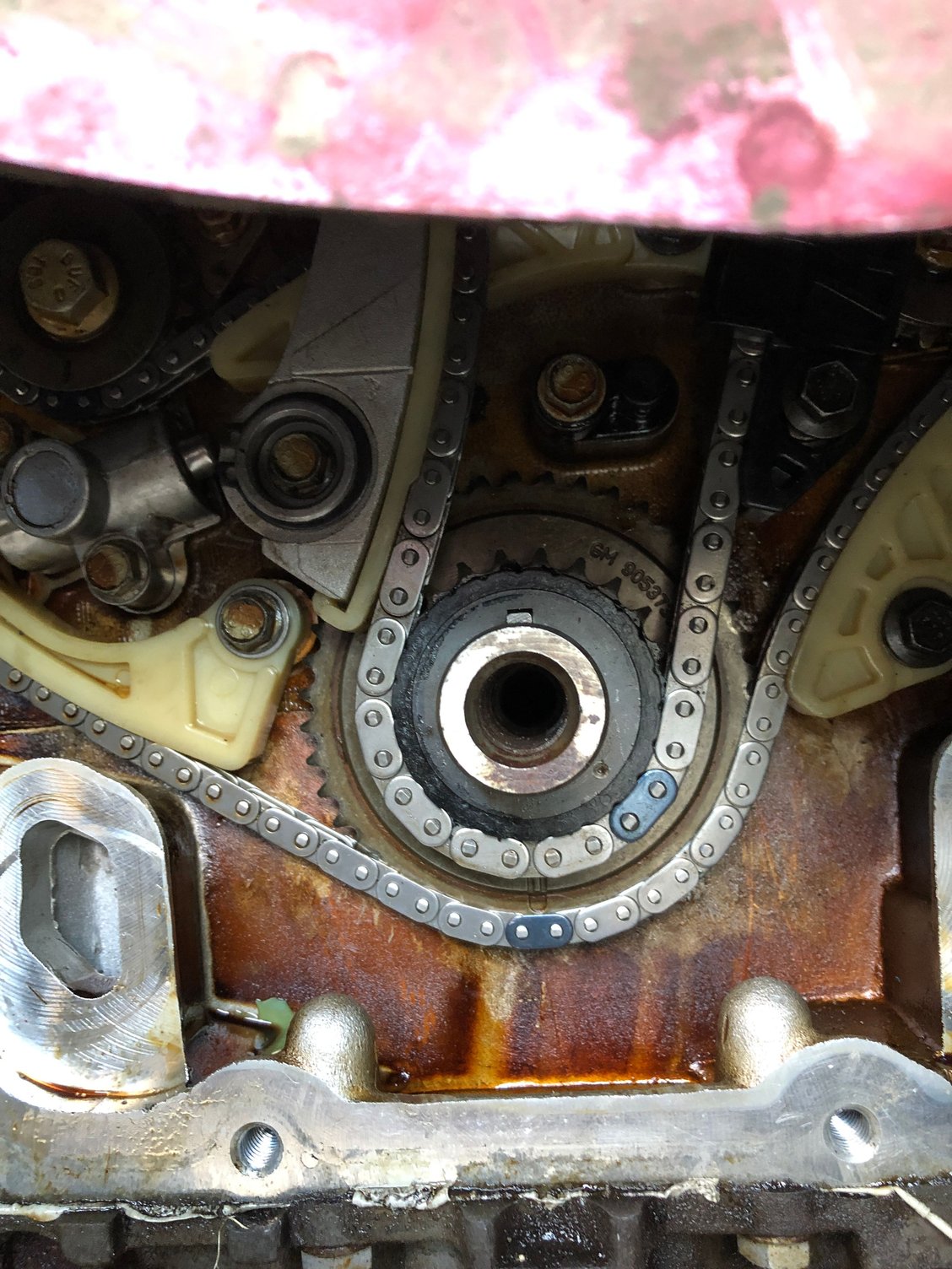

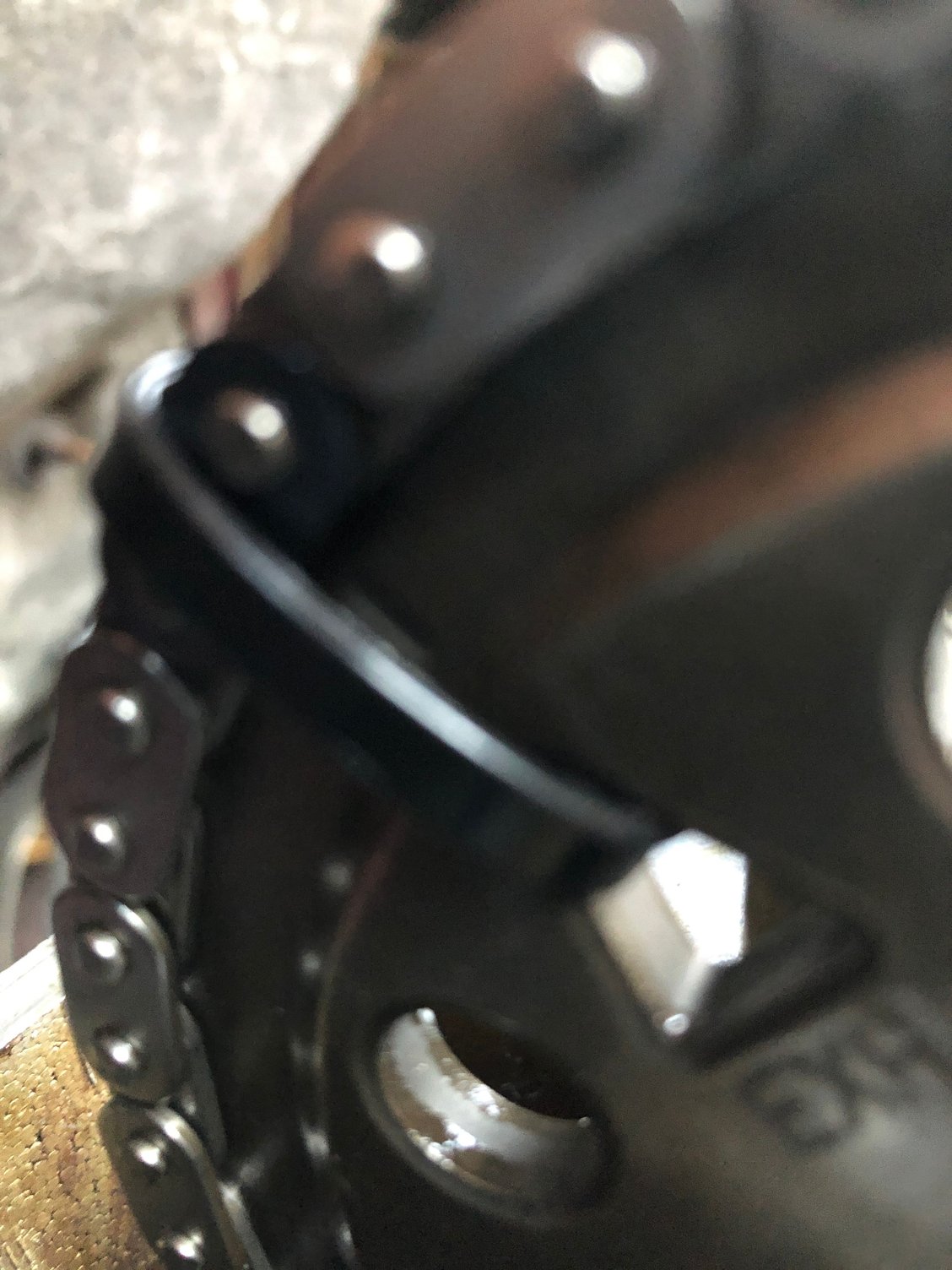

We got the valves replaced and the head torqued down, reset the balance shaft chain and reinstalled the timing chain.

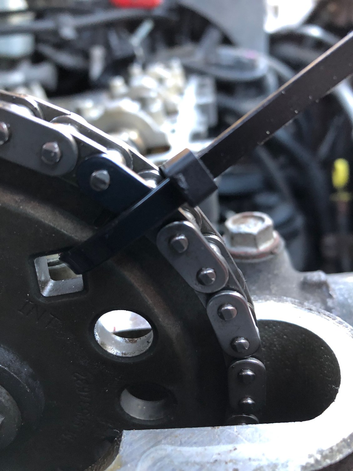

Used tywraps to hold the links in place! Intake dide
Exhaust side!
Ensured the timing chain was in the correct place , then installed the tensioner and gave it a smack to engage it, That took up all chain slack!
Intake balance gear in place
Exhaust balance shaft gear also aligned

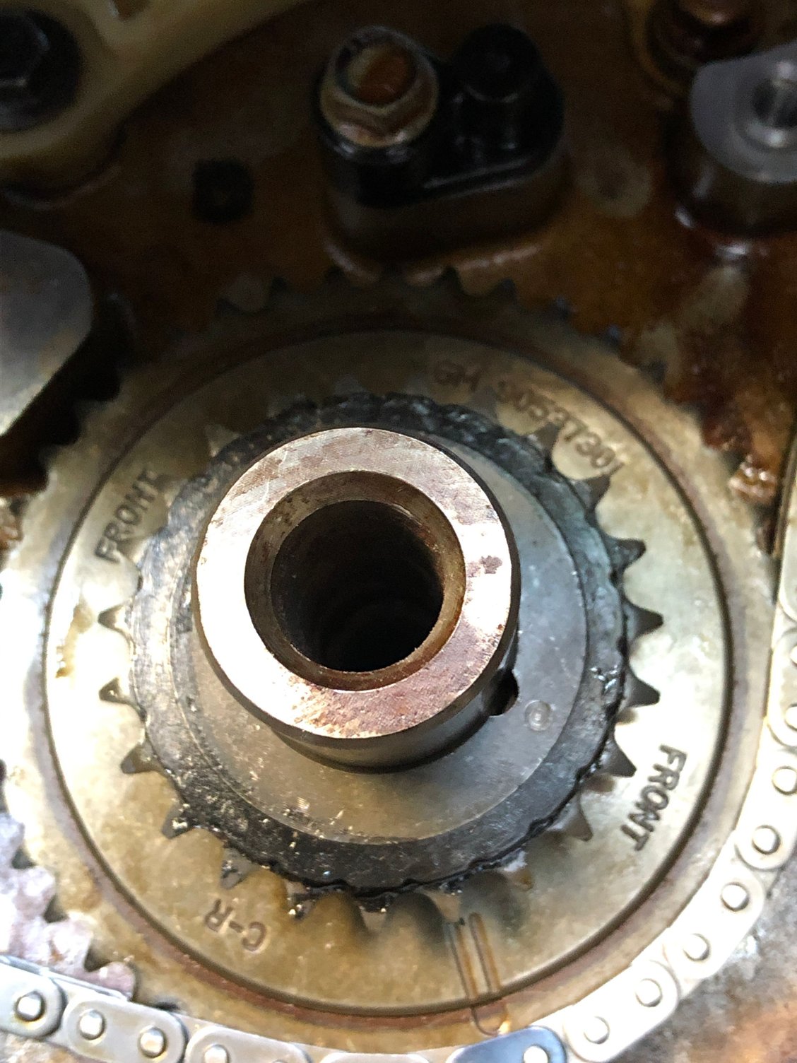

Balance shaft crankshaft gear aligned with the coloursed link.

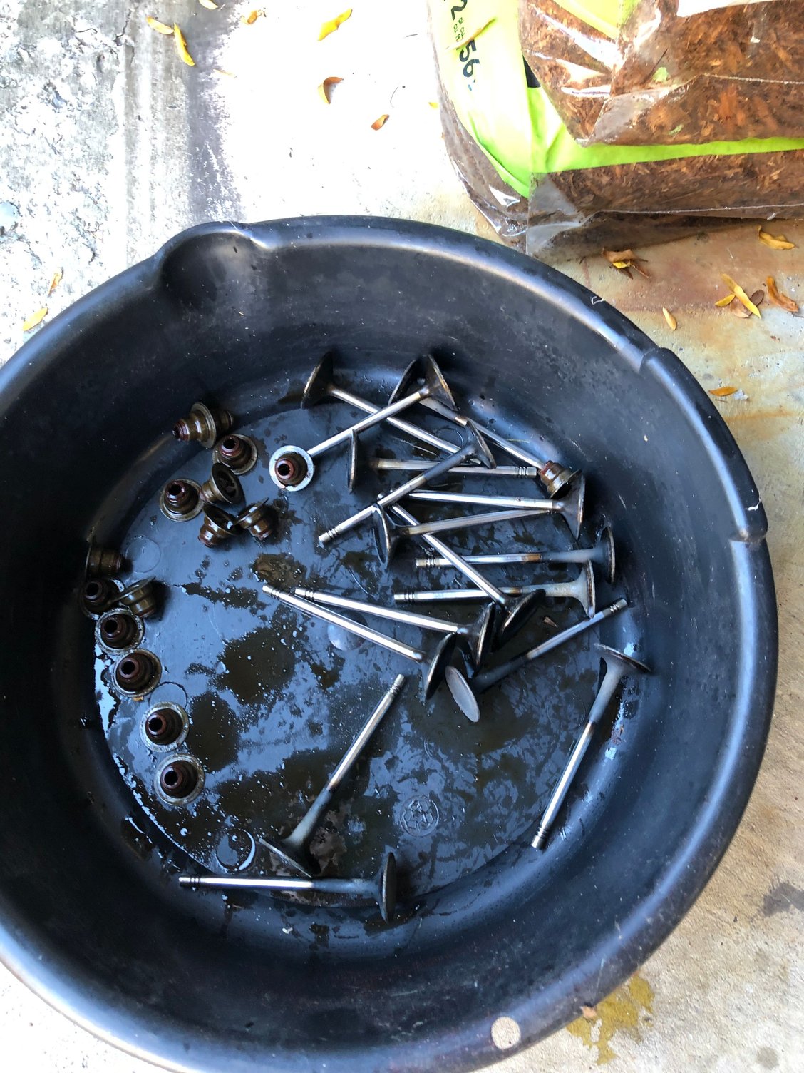

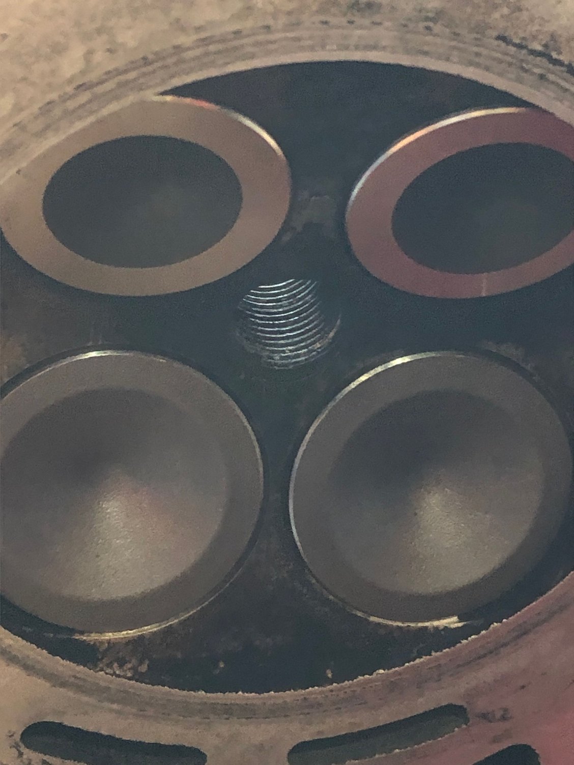

8 intake and 8 exhaust valves, scrapped out, and the valve guide seals

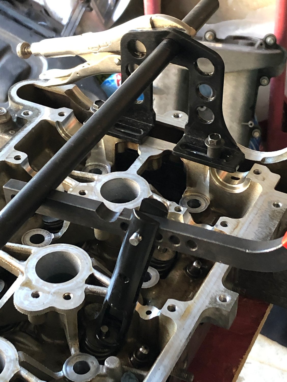

Used this handy tool to compress the valve springs then remove the valve keepers Then installed new seals and valves and used the tool again to reinstall the keepers

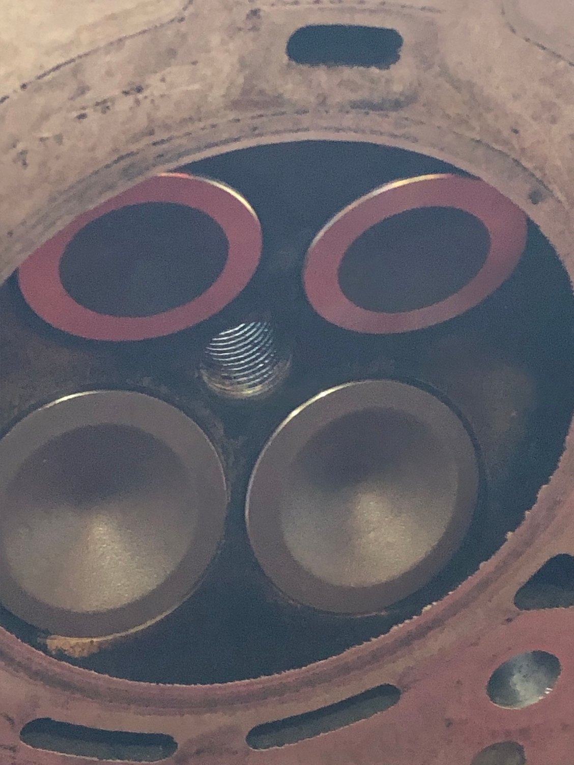

New valves, no gaps
Another cylinder
And another
Good thing there’s only four, eh?

Originally Posted by Oldblue
(snip)
New valves, no gaps
Blue- Cool, but did you 'lap in' each new valve ? It is an important step. Just looking is not enough.
And no de-carboning the combustion chambers.. Wow !!! Very surprised.
Old Oct 29, 2020 | 07:16 AM
  #18520
Posts: 39,900
Sleeper, The valves weren’t lapped during original assembly, and the carbon is cleaned off with brake cleaner spray, we just didn’t polish the head surface. It’s a 13 year old DD , it’ll be just fine!
