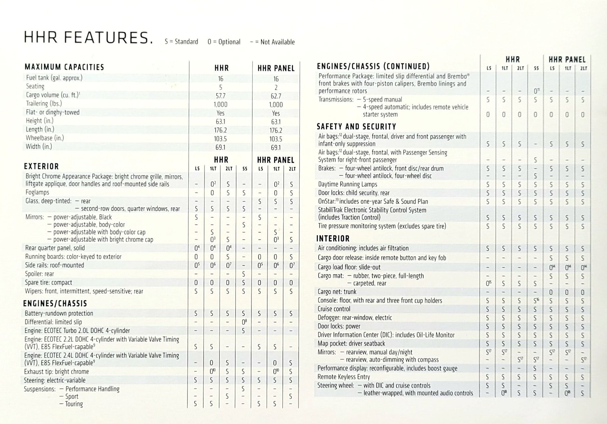

Here’s the 2010 sales brochure option page. As you can see, it shows:
  • 2.4L optional on 1LT only, standard on 2LT
  • FE3 exclusive to and standard on 2LT
I also have the 2008 brochure, which which is similar but did not allow the 5-sp manual with the 2.4L. I see no such restriction here.
As you can see, generally:
  • 1LS was the base model, and allowed few options
  • 1LT added little of substance but allowed a lot more options for the most flexibility
  • 2LT was loaded with most of the goodies standard, including a couple exclusives, with only a few remaining options
It's tricky to discern 1LT from 2LT in the wild. The chrome exhaust tip 2.4L telltale doesn't do it. Also, special editions are another can 'o worms.
Not discussing SS here (technically RPO 1SS,) which is in a class by itself.
As always, these principles don’t necessarily apply to fleet orders. They make their own rules.
