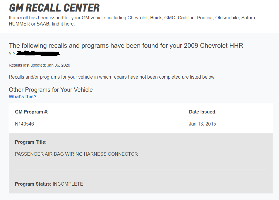

I've had the intermittent air bag light for the last week or so.
I just found this "recall". When I called the dealer, they don't call it a recall though. They call it a "customer satisfaction" something or other. Does anyone know what the difference is?
Anyhow, thank you all again for the great information on this site!

To begin you added a digit to the document number it is N14546. Whether it actually applies to you is another story. The OBD codes involved are B0019 & B0020.
Here is a pdf of the document with the letter GM sent to owners of record.
https://static.nhtsa.gov/odi/tsbs/20...57270-7549.pdf

Regarding the number, I was quoting an earlier post and didn't actually put that number in. :) Their number does line up with what I found online at the recall center though:
Old Jan 6, 2020 | 09:58 AM
Posts: 26,532
Whatever the number, they lied. It clearly states that the car is not to leave their facility without the fix regardless of years or mileage at no cost to the owner.
Print the pdf out and present them with the letter.

There are 2 places in the documents that very clearly state that if your car is driven onto a GM dealers lot it is not to drive off it without the repair. That sounds really recallish to me.
However, it also says the codes need to be present, your problem may not be the same.
