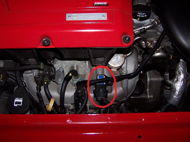

There may be a sticker inside the fuel door. The original said 'premium fuel recommended' or something to that effect. With the upgrade, the new sticker would say 'premium fuel required'.
The TMAP sensors would have been upgraded to Bosch units. There is one on the intake manifold and one on the lower charge pipe. The Bosch units are blue.
If you're on the stock tune, you should get around 14-15 PSI of boost. 19-20 PSI with the upgrade.

The GMTU or Stage 1 will have the Bosch Tmap sensors like pictured below as
RJ_RS_SS_350 said.
Name:  Bosch Sensor.jpg
