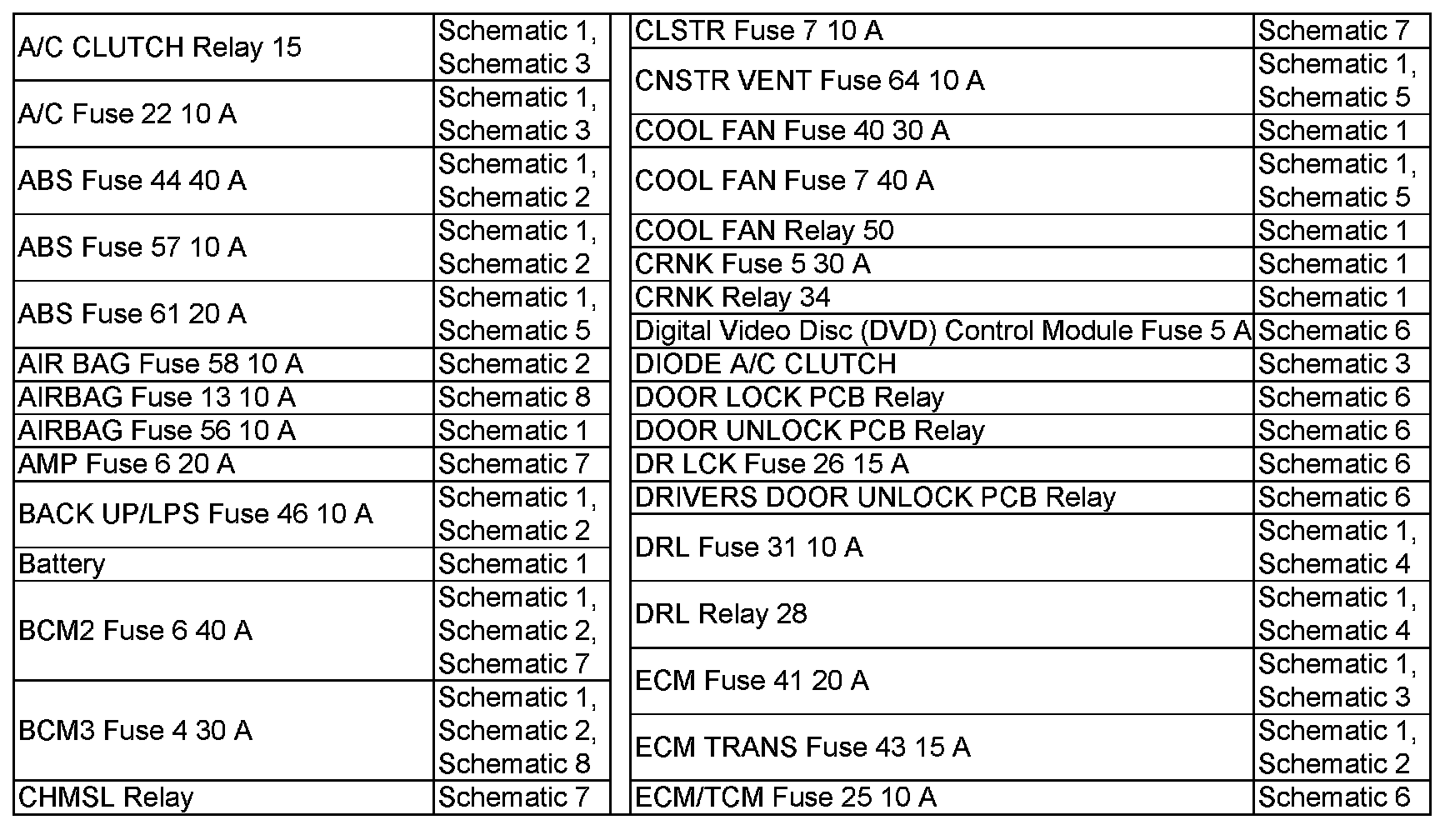

Click around. Entire manual is in here.
Operation CHARM: Car repair manuals for everyone.
Home >> Chevrolet >> 2010 >> HHR L4-2.0L Turbo >> Repair and Diagnosis >> Starting and Charging >> Power and Ground Distribution >> Diagrams >> Electrical Diagrams >> Power Distribution Schematics >> Wiring Schematic Index
A/C CLUTCH Relay 15-ECM/TCM Fuse 25 10 A:
https://charm.li/images/DM14Q313/gm81/1401153990/

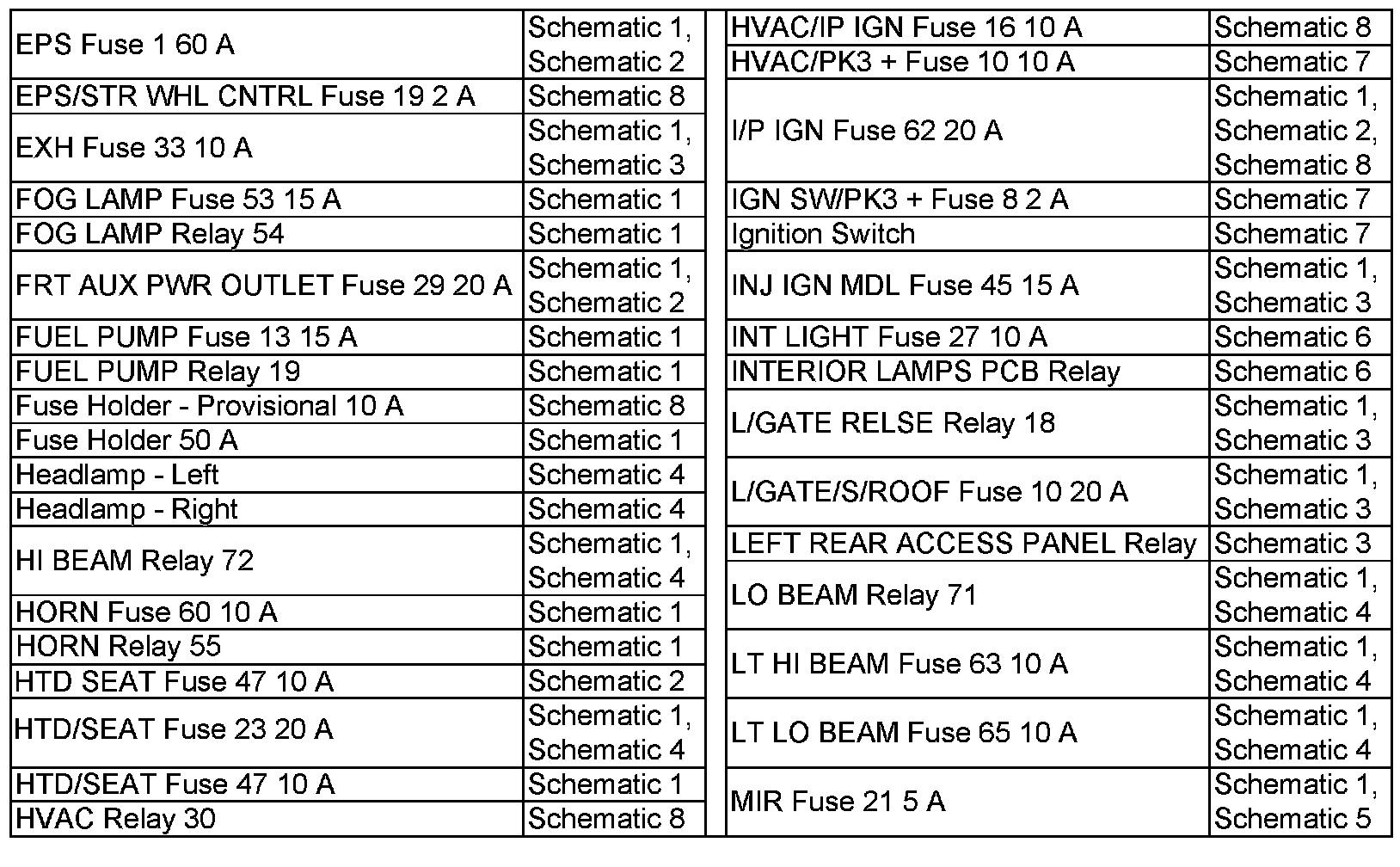

EPS Fuse 1 60 A-MIR Fuse 21 5 A:
https://charm.li/images/DM14Q313/gm81/1401177176/

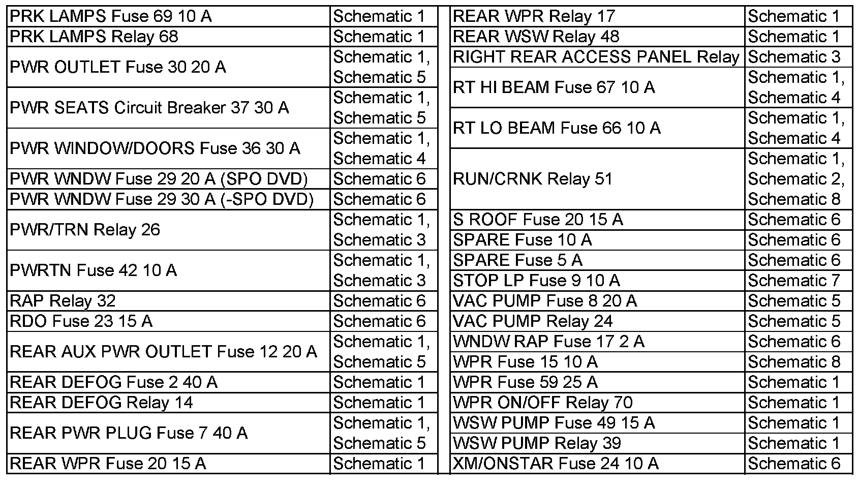

PRK LAMPS Fuse 69 10 A-XM/ONSTAR Fuse 24 10 A:
https://charm.li/images/DM14Q313/gm81/1401201321/
