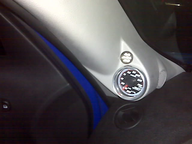

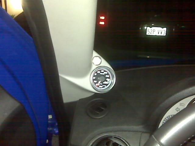

If you get a shift light, let me know how you wire it in. There is a company that sells very small shift lights that will fit right next to the stock boost gauge. I have mine installed, but I've yet to really look hard and find the tach signal wire to get it hooked up. IMHO, the Aeroforce lights aren't bright enough for use as a shift light.
