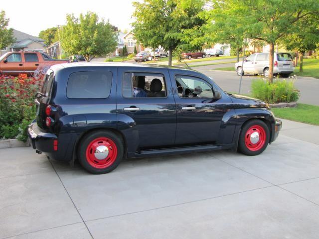

Canuck Motorsports lowering springs, a full 2 inches out back and 1 1/2 inches up front. Installed in spring of 2010 at 58,000 miles, still in the car now I sold it in October 2019 at 286,000 miles, it’s always rode nice and level. Tell ‘em Oldblue sent you!

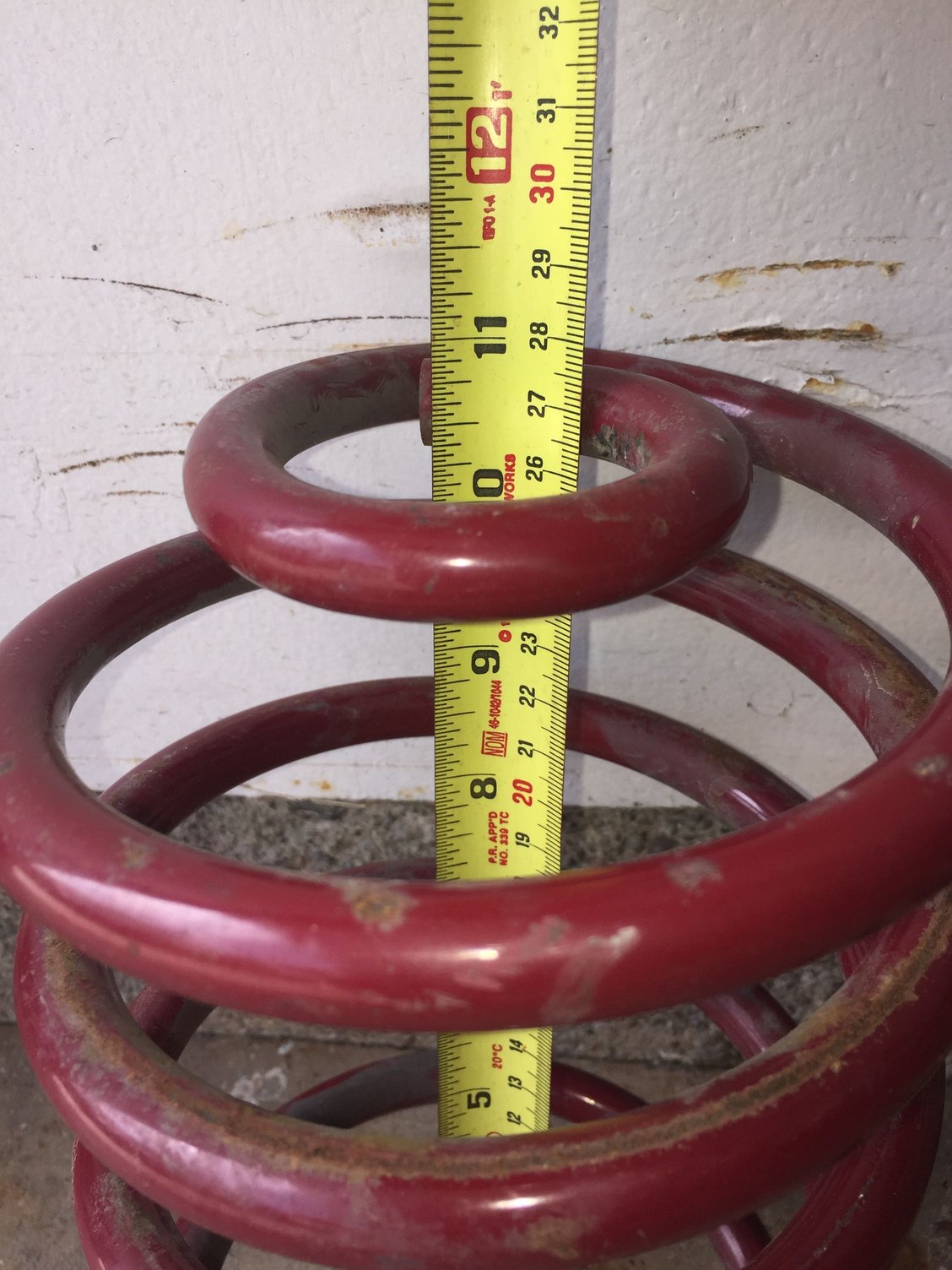

The full 2 inch lowering spring
The 1 1/2 inch lowering spring, because the springs are pigtailed at both ends you can’t cut them. Because they are progressive rate , you can’t heat them.
