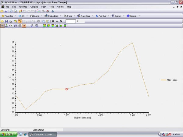

Our ECM is torque based…
Torque is delivered, based on the "Desired-Air-Load" table…
If you have an automatic HHR SS, with the stock "tune", you are being
restricted in so may ways, as GM really went to far, in limiting torque,
in order to prevent warranty issues, with the automatic.
These two tables, show how the stock program, bites, big time:
The 1st table shows torque being limited, in all but 3rd gear !!!!
The table gear headings, show an HPTuner error, should be 1,2,3,4,5 instead of 1,2,4,5,6, so where you see 100%, on the table, it is really 3rd gear, not 4th. Just a small typo error by HPTuner...
Most all "tunes", even the GMPP turbo upgrade "tune" have 100% power in 1st, 2nd, 3rd & 4th gears, with automatics...
You only get FULL power, in 3th gear, with the stock automatic HHR SS...
This table below, is the really ****ty automatic power curve, so bad, really, really, bad...
This table below, is a typical power curve, when "tuned"…
So, bottom line, you will always here stories, & posts, from guys with stock automatic HHR SS, about weird boost problems,
& why is my boost low at different times, or at different speeds, or in different gears, ect, ect...
It's all to do, with the stock , ****ty HHR SS automatic ECM programming...
Please, friends, don't let friends, drive HHR SS automatics, with the stock ECM program.
Please, get a "tune", any "tune", any & all "tunes", are better then the stock ****ty Automatic tune…
With any "tune", your buggy will feel like, well, like your buggy should feel like, fast & powerful...
