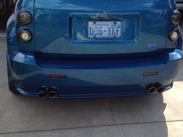

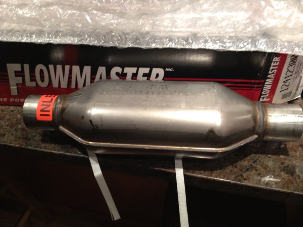

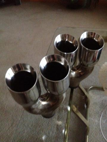

I like my setup. (it's in my sig )
A little more noise than stock, but no snap, crackle, pop or fart noise sounds.
Plus. No drone noise at cruising speeds.
