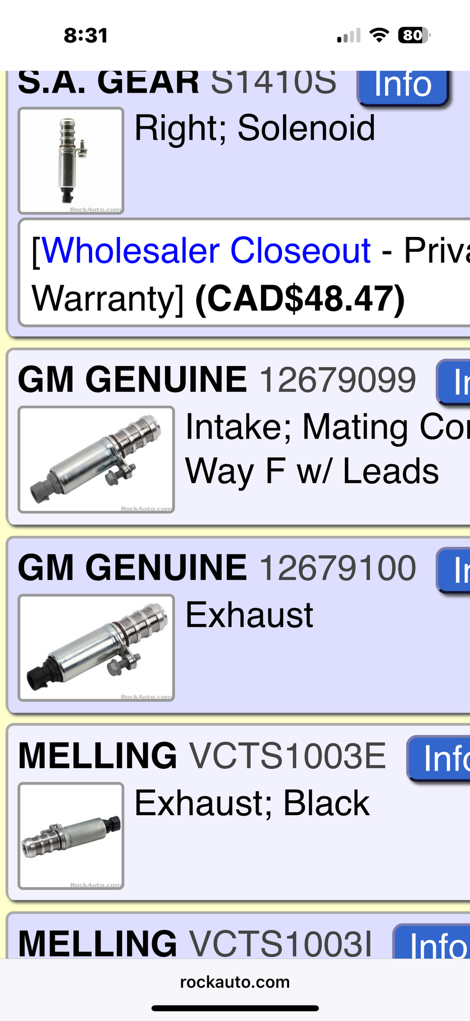

P0011 is typically the intake VVT solenoid, is it not? Time to replace both solenoids then? I'll check the wiring first of course.
BTW, my '08 SS only has about 120,000 km (~77,000 miles) on it so not a high mileage vehicle.
Are these A-Premium solenoids okay quality?

The car might be running better, but with P0011, it's not optimal. Replacing the VVT solenoid valves might work. I would start by inspecting the intake one, looking for shavings or gunk. Then replace both. It may be time to do a chain job, especially if oil changes have been neglected.
