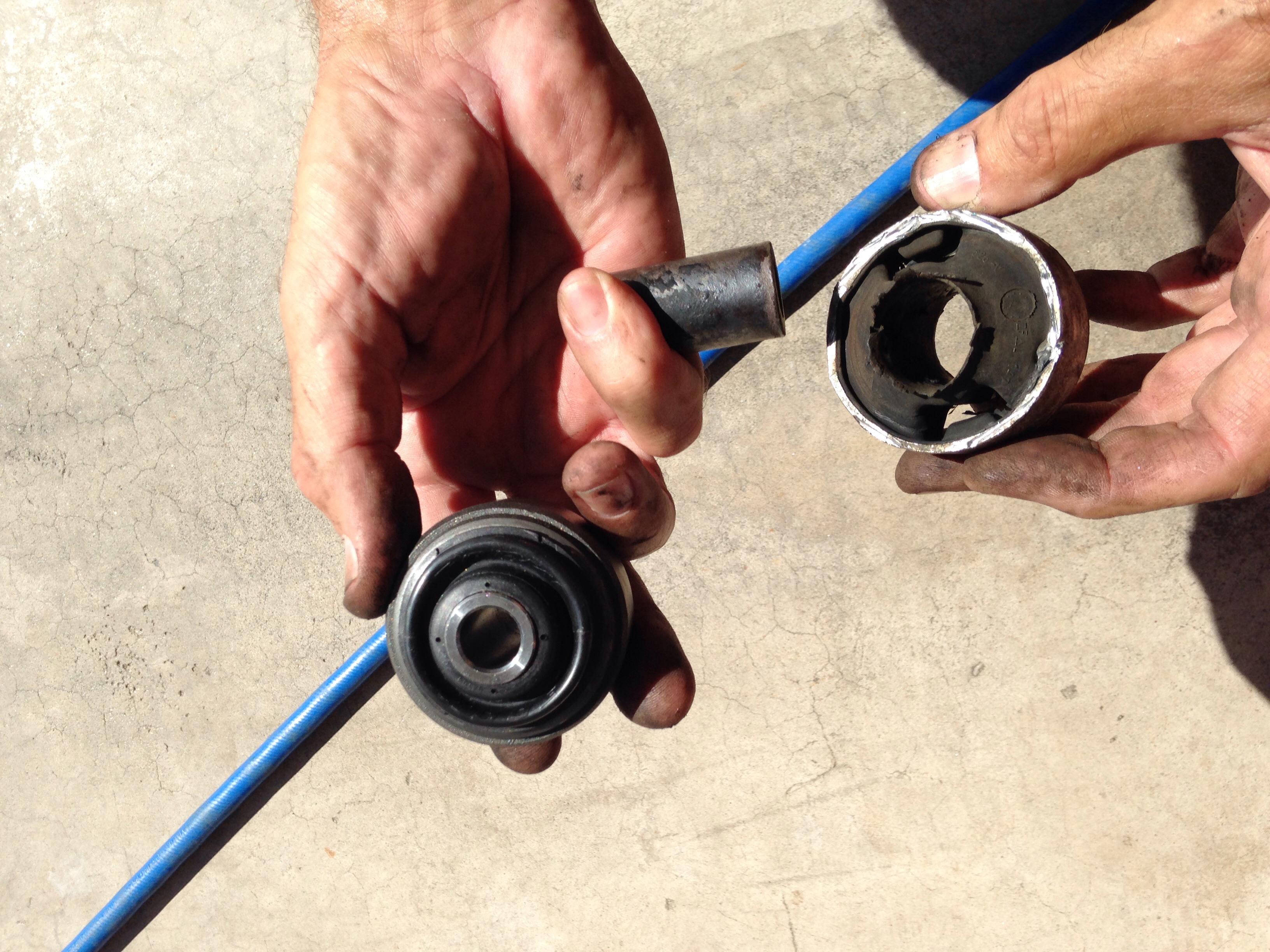

I have the larger SS non Brembo rotors and have not problem with warping rotors, I've had solid smooth non drilled non grooved rotors from crossdrilledrotors.com, it was a good deal for rotors and pads, the rotors are ground smooth not cut on a lathe, good quality got almost 60,000 on them now and no issues.
My braking vibration was my LCA rear bushings shot , again! Same time frame as the first set , 100,000k and 4 years.
I used Moog problem solvers this time very good feel and handling no more shake while braking, or clinking over the bumps and pot holes.

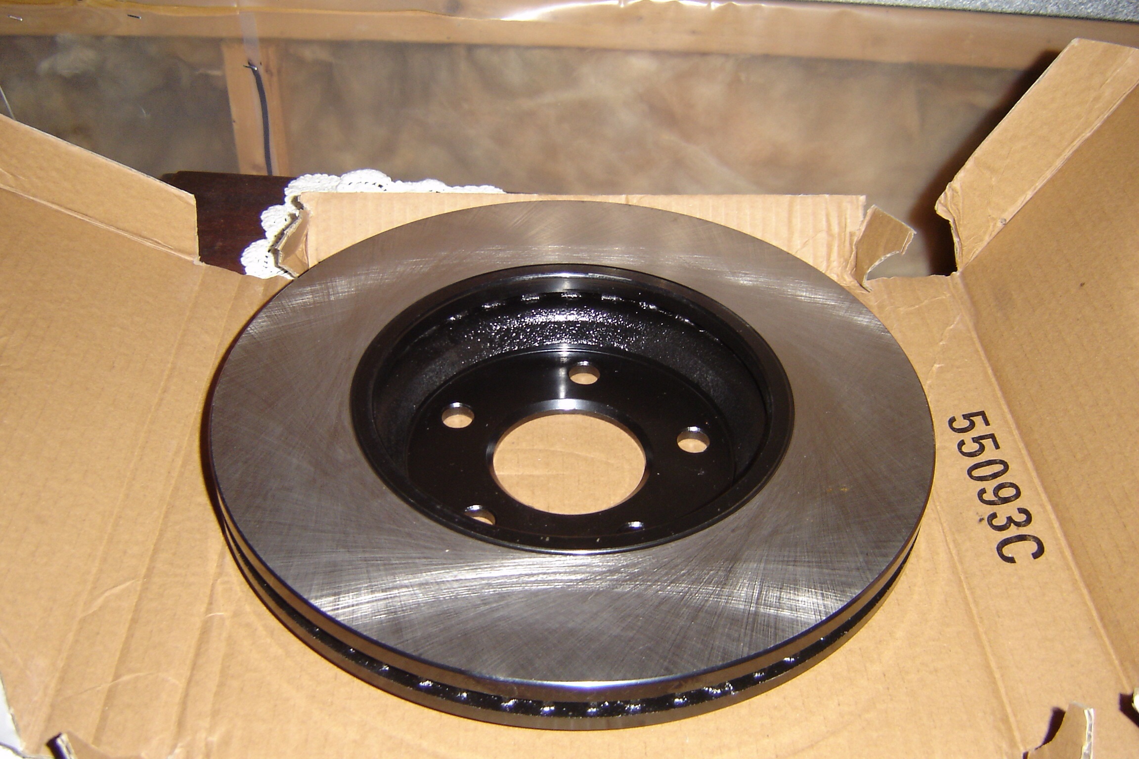

And those rotors
