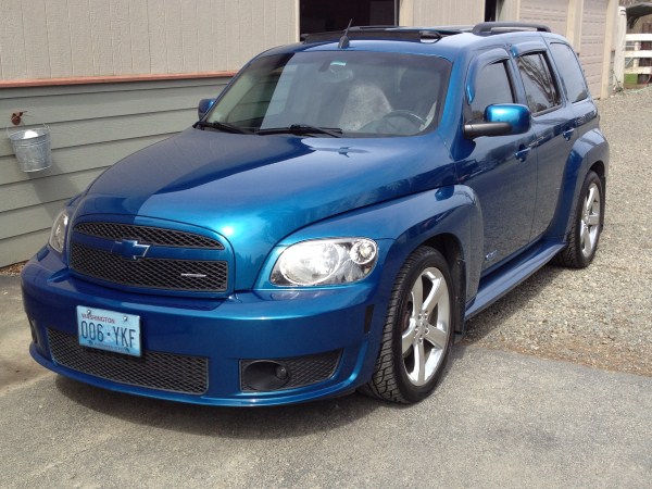

Do these look over loaded ? They are 255, and I have had 245's (F-1as) that were too wide for the SS wheel. There is a bunch of width difference between tires. The new ones you got look sticky, have you go a chance to apply some horsepower to them???

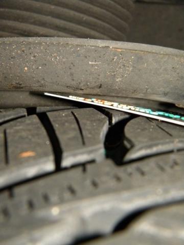

i'm running 245/40 555s on the stock wheels, dropped on Goldlines. only a tiny bit of rubbing at full lock, other than that, no issues. are you on Pedders springs or coilovers? IIRC when I was looking into it, a 255/40 would put the tire dang close to the spring land on the stock struts, due to being a bit larger diameter vs stock (a big part of why i went with the size i did). I could consult any number of tire size calculators online to verify this, but i think diameter wise 255/35 would be the right size if you wanted the 255s, unless you don't care about speedo error.
Old May 5, 2012 | 09:13 AM
You mean close like this ? Remember the card was a little swollen at the time, it just paid for two sets of them.
