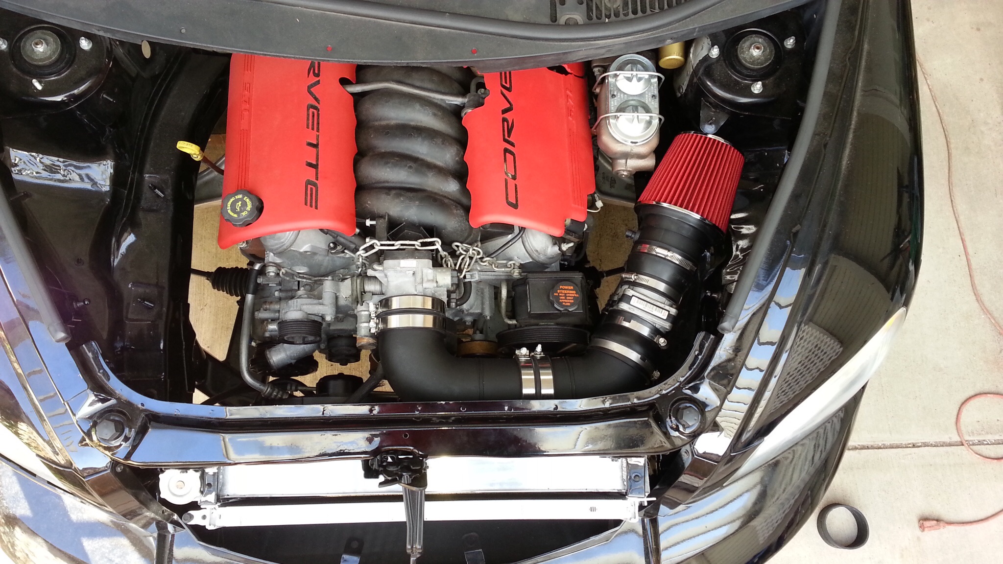

[/IMG]Cool…
LS engines rock….

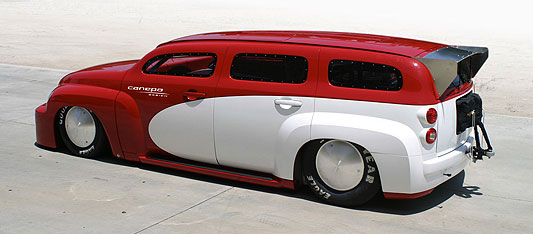

But, I'd put my money on this 1,000HP 2.0 Ecotec HHR...
HHR construction 10
Canepa Design
