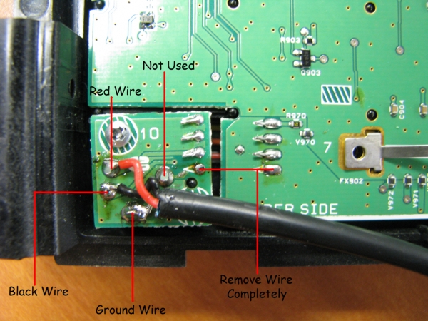

HOW TO:
1.) Remove Radio Completely From Car
2.) Remove Radio Front Bezel
3.) Follow Picture Instructions in sequence.
4.) Route New Wire through holes in Radio and ENJOY!!!
