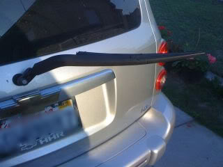

Remove cover at bottom of Wiper Arm

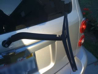

Pull wiper arm upright
Rotate blade untill it forms a T
Then pull off Blade
put new blade on and reverse

Once you pull the nut cover off, snap off the little tab and you can pull your wiper us like that each time you wash without taking it off.. Did mine the weekend I brought it home.
