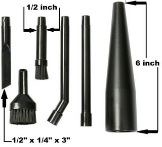

If you don't have parts laying around to rig up a vacuum attachment, Shop Vac sells a micro cleaning attachment set (Shop Vac part # 801-89-00) that works with 1 1/4" hoses & "should" work quite well for the vacuum needs for this project. It can occasionally be found for less than $10, but usually $12 - $15 at your local "mart"
Attachment 47940
