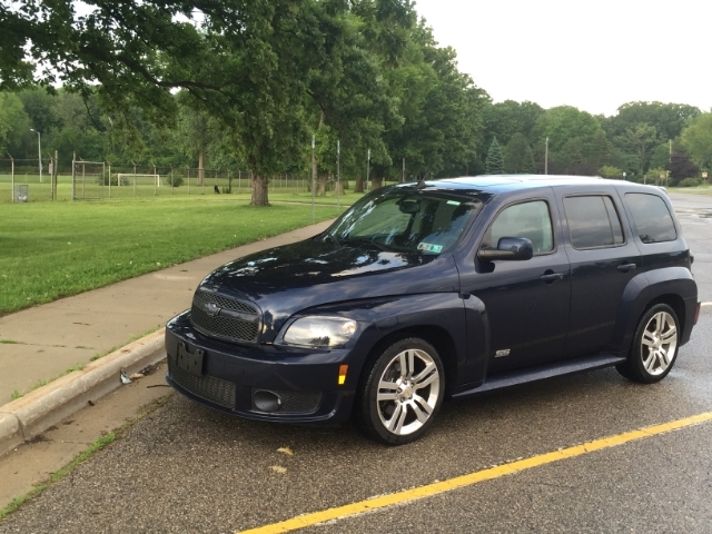

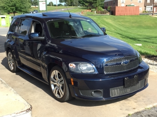

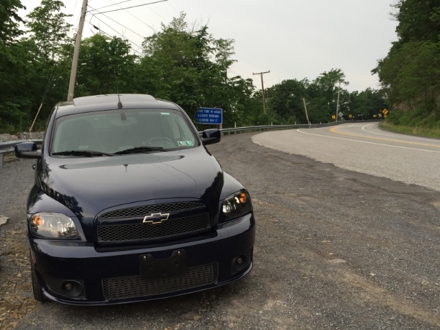

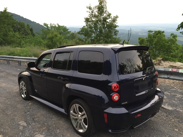

Pictures as requested:

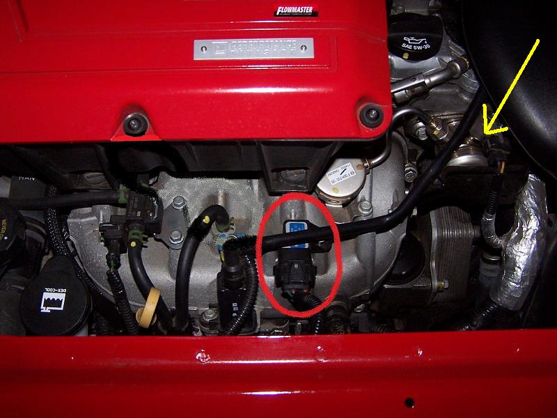

Or, just look at the upper Tmap sensor on the intake manifold. The stock sensor is black with small white parts numbers. The upgrade would have a Bosch sensor with a blue label.

So After further investigation, I do have the blue labelled sensor, and it will spike to 17psi, and a little more power than 260, but it doesn't hold. The sensor has 4 wires coming from it, but one of the wires comes to an end before meeting the rest of the harness. Maybe I am just missing a flash then?
