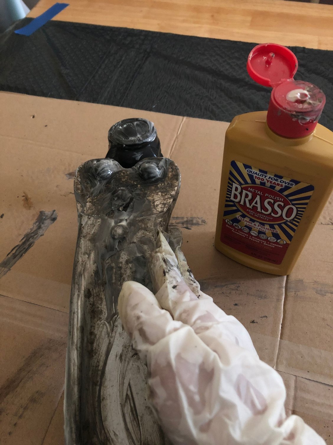

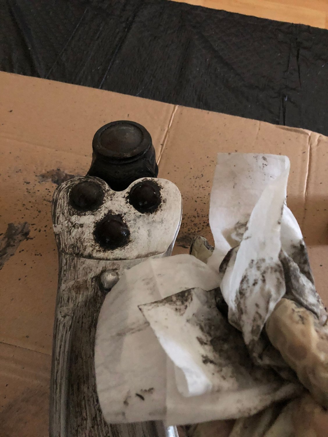

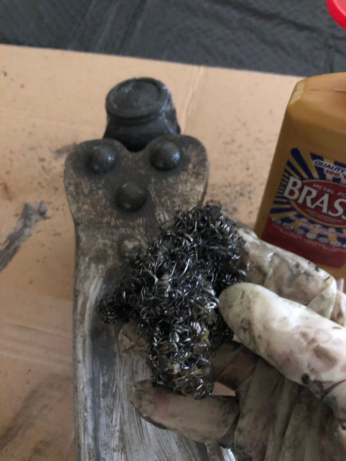

Cleaning cooked on grease.
I used brasso to clean my aluminum control arms. I was super excited at how it got the gummed up junk off in seconds. 😁😁😁

Brasso is ammonia, don't leave it on aluminum for very long. A few minutes is ok. Just about any of the "color" cleaners work well, Orange, Purple, Green etc. Along with oven cleaner, ammonia again.
Old Aug 11, 2020 | 04:31 PM
Posts: 11,721
X2 what Don said.
If using Brasso on bare aluminum, you should give it a soap bath afterwards to wash off the ammonia residue.
