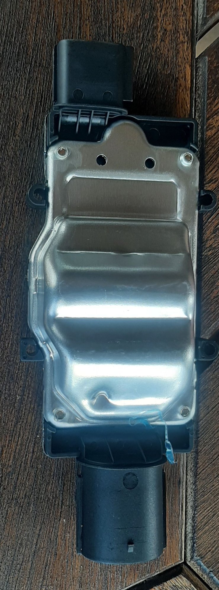

SS has a PWM controller for the fan that does wear out. It is located on the fan shroud with wires on both sides. Not very expensive, here is one on ebay; They also come with a new fan/shroud assembly.

Also, check the wiring that plugs into the fan module. I recall a couple of SS owners on this site found some burnt wiring or connectors in the harness. My memory says it was somewhere close to that module.

Where is the cooling fan module located exactly, I ordered the one from the link here.. Dont see it right off
Here's a picture of the module

The fan and assembly is one of the thing that is NOT common to all HHR. Don't get one that says "fits all".
