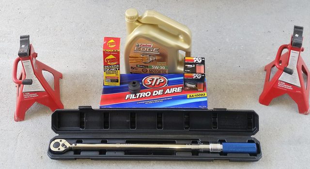

Today is maintenance day, & today's maintenance is: Air Filter change & Oil change which I always do at the same time.. I'll eventually get a K&N air filter (in time for next change), but for now, I just picked up an STP since no one around here carries the correct K&N air filter. The Castrol Edge extended mileage was only $3 more than Mobile 1, & I've always had good luck with Castrol, so that's what I'm using. Also picked up a nice new torque wrench which will stay in the car as a lug wrench!!!
