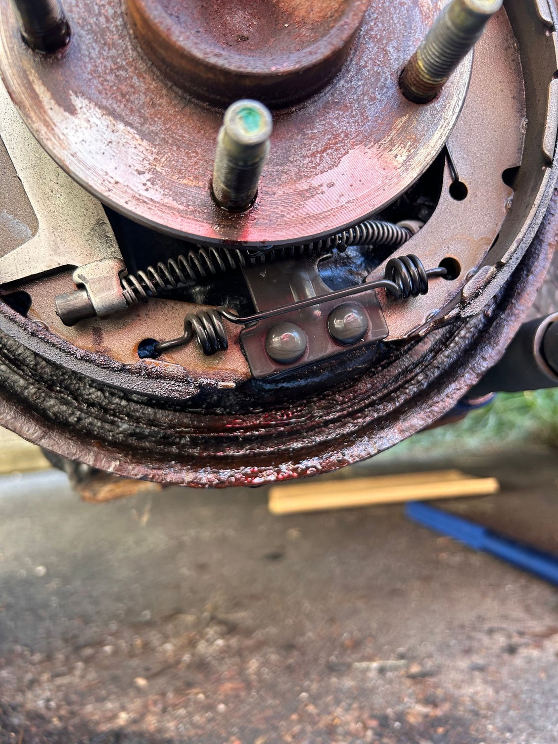

I just did the brake shoes on the back of my 2011 LT HHR. Hadn’t done rear drums in 30 years so I decided to watch a few YouTube videos. I noticed that there seems to be two different designs
Mine has a total of six springs holding everything together. The other design only uses four springs.
What years had the four springs and which had the six springs?

Oldblue Sep 13, 2024 03:35 PM
2006 thru early 2009 had the horseshoe spring style, 2009 thru 2011 had the old Chevy pin thru the spring and a clip to hold the shoe in place, like in your photos

firemangeorge Sep 13, 2024 04:24 PM
So. For us southerners, what is up with that corrosion ? Salt ? Leaking wheel cylinder ? Never seen anything like that before.
Oldblue Sep 14, 2024 07:58 AM
Salt brine!

jimvw Sep 14, 2024 10:53 AM
Standard rust up here where the water freezes in the winter months. They throw salt and calcium chloride on the roads to melt the ice, sometimes it works! also helps to lighten up the cars for better MPG and keeps old cars off the roads.
fluid in the picture is probably penetrating oil to get the drum off.
Fierojo Sep 14, 2024 12:57 PM
And lots of break cleaner. HHR came from upstate New York where they use salt instead of asphalt.
