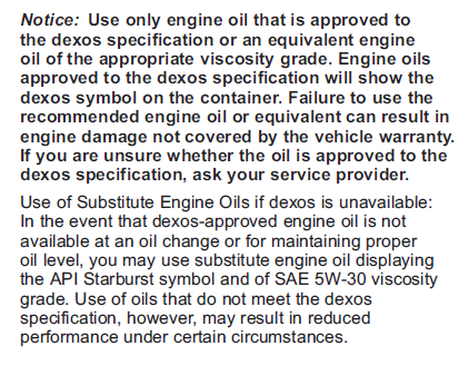

If you carefully parse the statement in the Owner Manual; you will see that dexos has nothing to do with the warranty reference. ("or equivalent" is used twice.)
It basically says use the 5W30 you want. It is hard to find a non-Starburst oil.
From page 6-18 of the 2011 HHR Owner Manual (BTW, the 2011 rec is dexos1):
