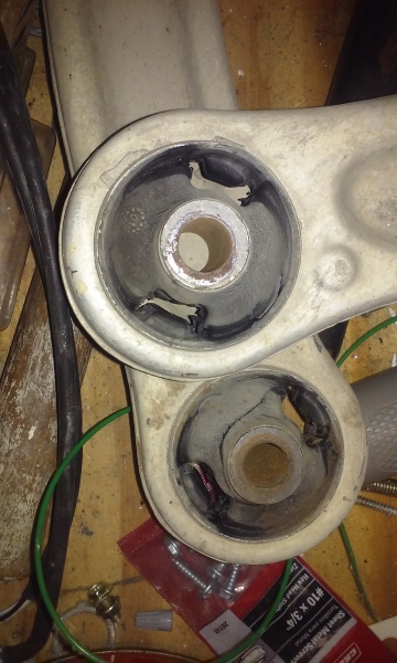

If I was replacing things based on age the LCA assemblies would top my list. They also cause: "brake judder", wobbly front end, loose front end, bad camber, bad toe & etc.
You would be shocked at what your LCA bushings look like after 130,000 miles, you can't see the cracking until you pull them off. I thought mine were fine on visual inspection and prodding with a bar, then I noticed the RF wheel hanging with an obvious Camber while rotating my tires. It was cracked all the way through in one spot and the other side was showing signs.
Keep a close eye on your tire wear! That RF went fast with the camber out. And then the inside of both tires wore really fast after replacing the LCAs, because I had it aligned a while ago and the guy didn't notice the bad parts, so now the toe was way off. Thankfully, the tires were already nearly at the Guarantee mileage (4K over now) and I have a new set in the garage.

Both of these LCA bushings looked good on the car. The one on top is actually "normalish".
