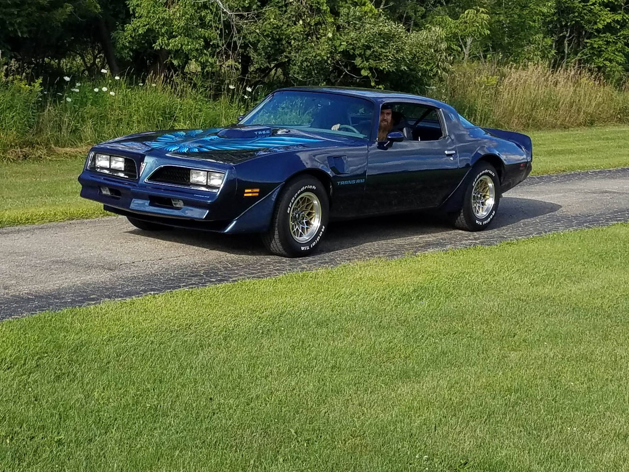

I no longer look at the oil change percentage reminder. I write it down and use a magnet on my tool box lid. About a year ago I was toggling thru the the DIC and saw 45% remaining. Checked my note on the tool box and it was at 4600 miles. Changed the oil that afternoon. I now use the odometer trip #2 as the oil change reminder. Sort of a double reminder. 211K and I use NAPA full synthetic and a wix filter. ( Napa oil is Valvoline oil) The 2.2 engine does not use any oil between changes, but I still check it once a month. Engine flush? Years ago I did it. 301 Pontiac engine.( 1979 Tran Am) I used the old method, automatic trans fluid. Added 1 quart to the engine and drove it. Then changed the oil. Seems like way more than 6 quarts came out and it was filthy crudy oil. The lifters ticked all of a sudden. More than likely plugged the oil filter. Dumb idea. Never again. This was back in the mid 90's. The engine spun a rod bearing soon after that. Replaced the engine with a Chevy 400 and still own that car today.
Old Oct 3, 2022 | 10:13 AM
Posts: 40,082
Nice Firechicken
