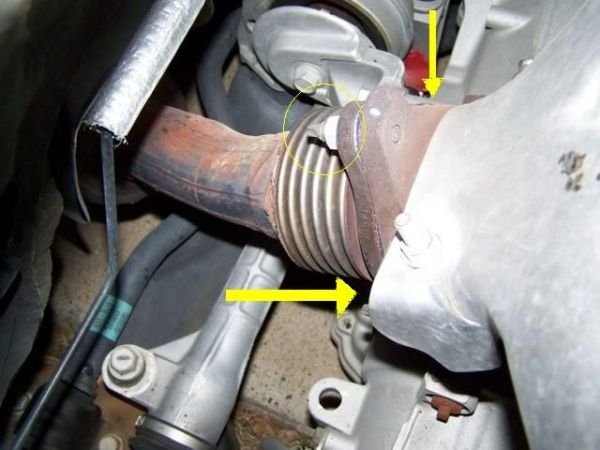

Flex pipe is the accordion bit from the exhaust header to the exhaust pipe. They crack with regularity as a result of worn motor mounts. Dead center in back of engine.
You can replace the cold air intake hose with a bit of metallic hose from Home Depot.
Old Jun 21, 2022 | 12:44 PM
Posts: 40,082
This what the flex pipe looks like. You are speaking of the woolly worm that bring cold air in from the inner fender
