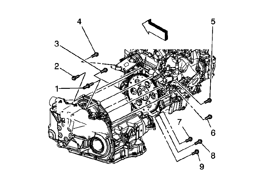

Old Jul 28, 2017 | 05:00 PM
Posts: 26,532
Mitchell says 66 lb ft.

Old Jul 28, 2017 | 05:01 PM
aradmahogany's Avatar
Joined: 09-16-2013
Posts: 1,408
From: Tampa, Florida
Attachment 45279
That's what they all got now!
