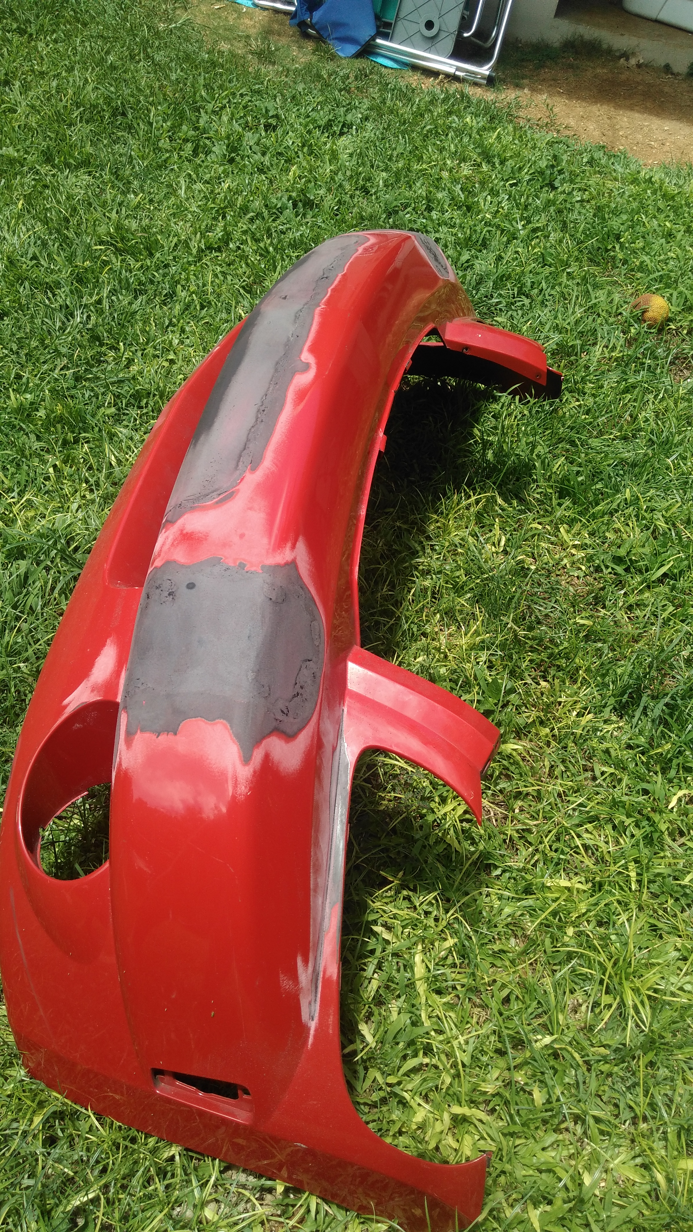

Respect For Bodywork Guys

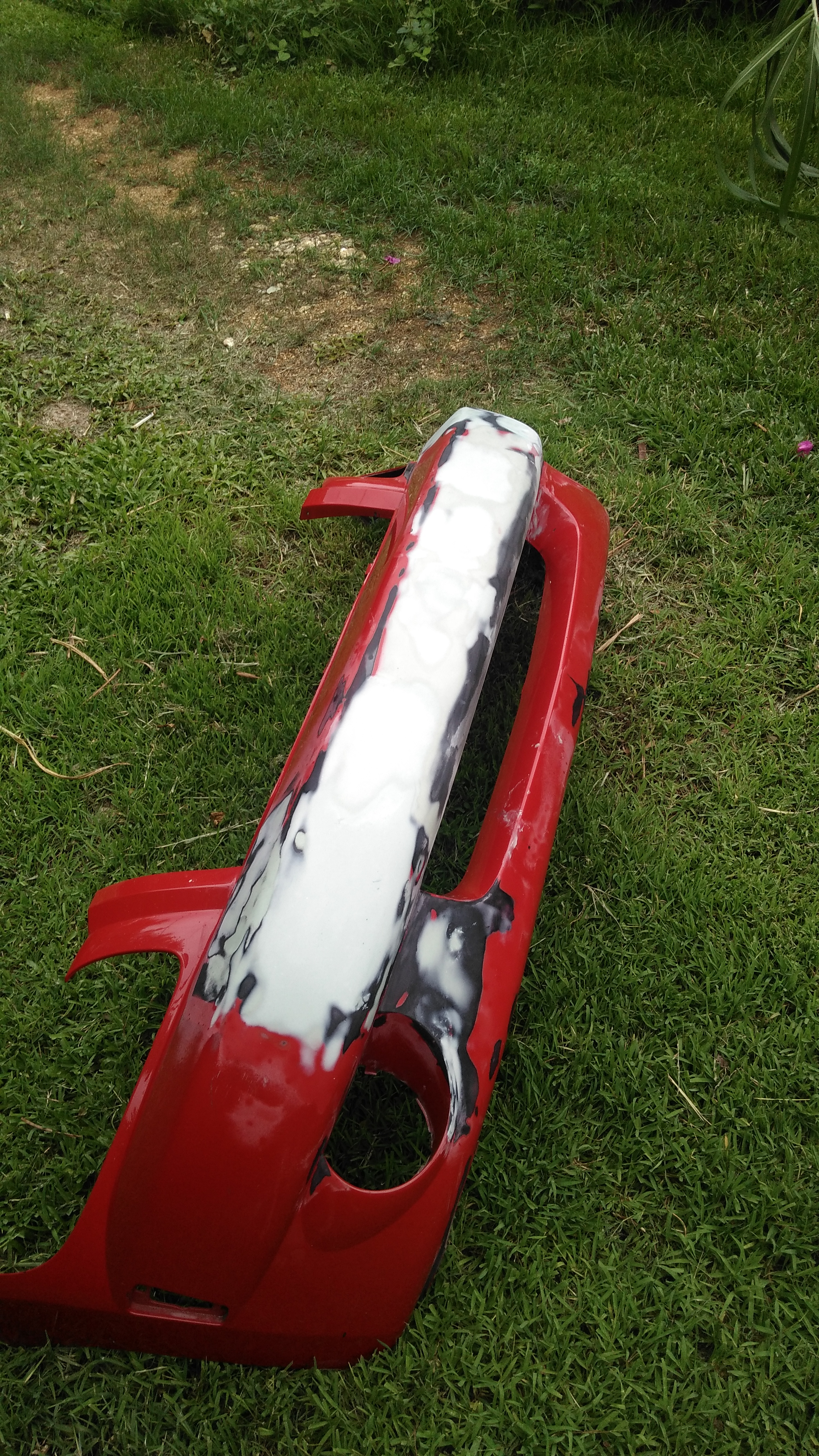

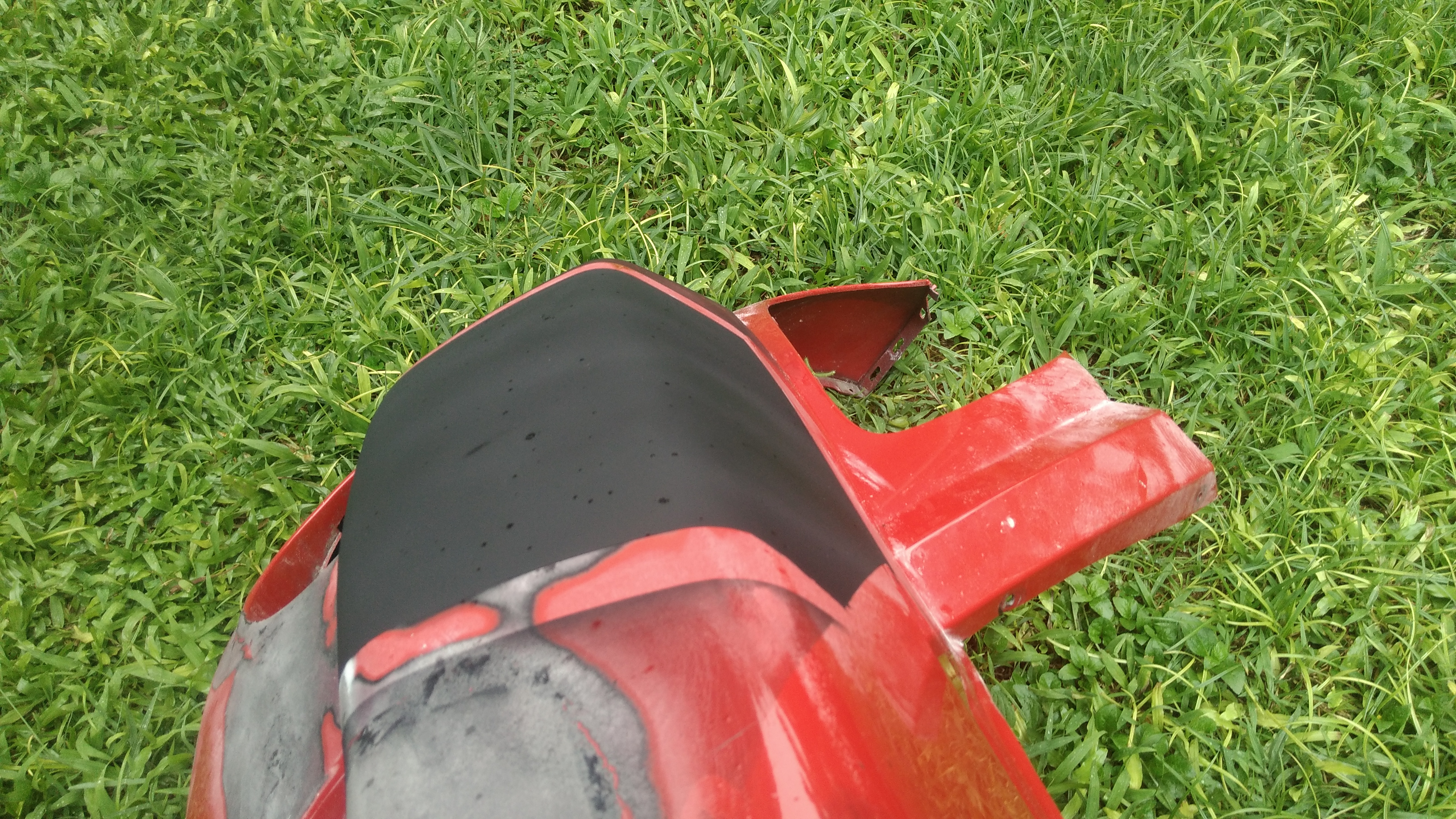

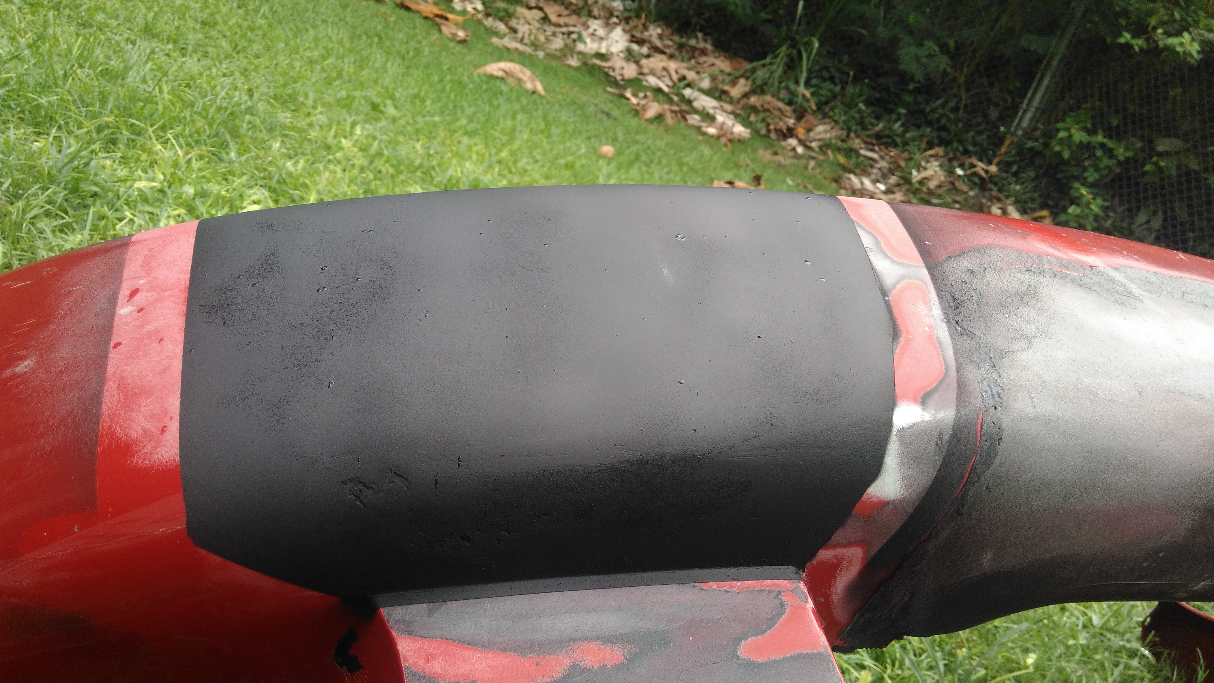

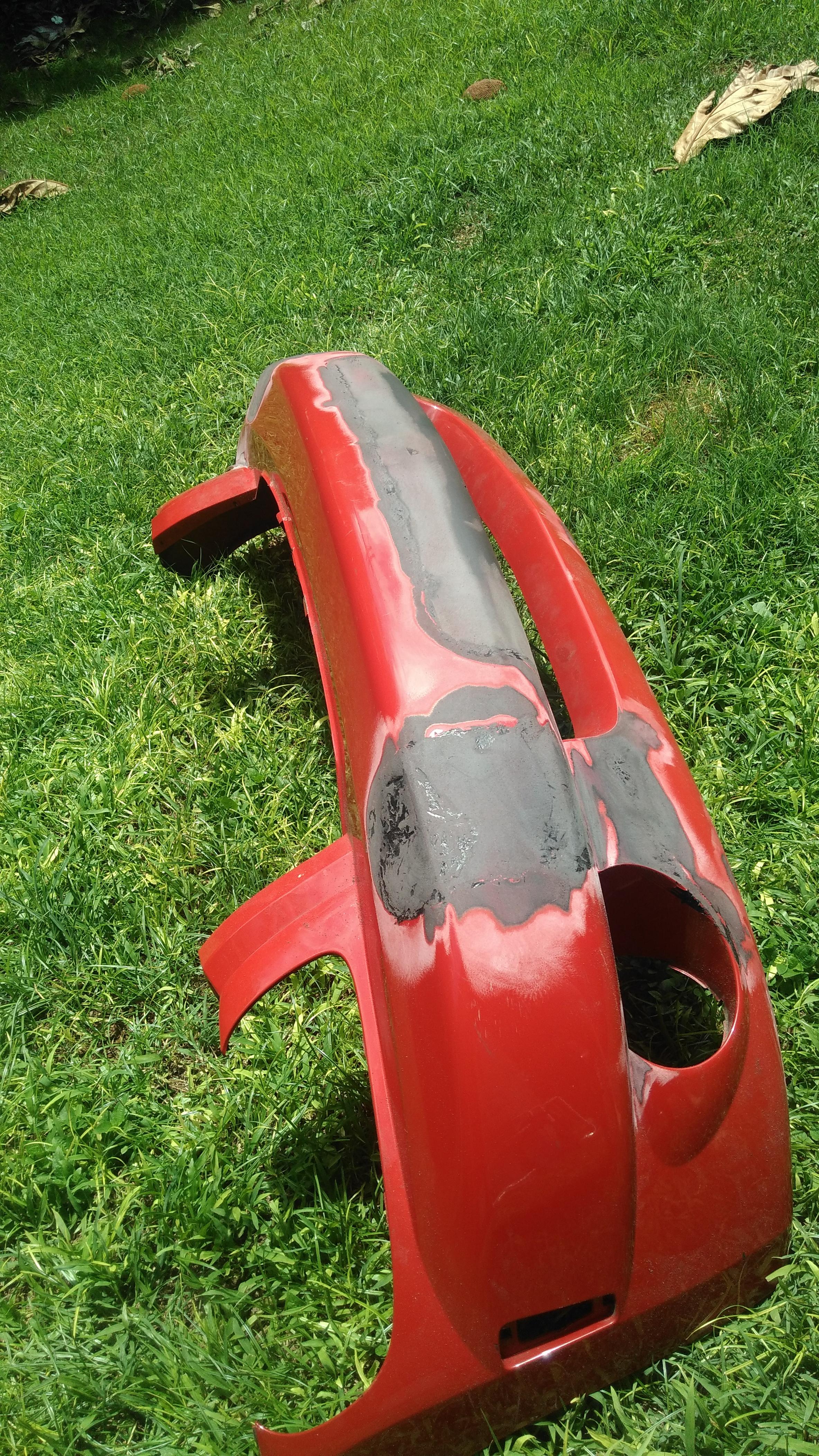

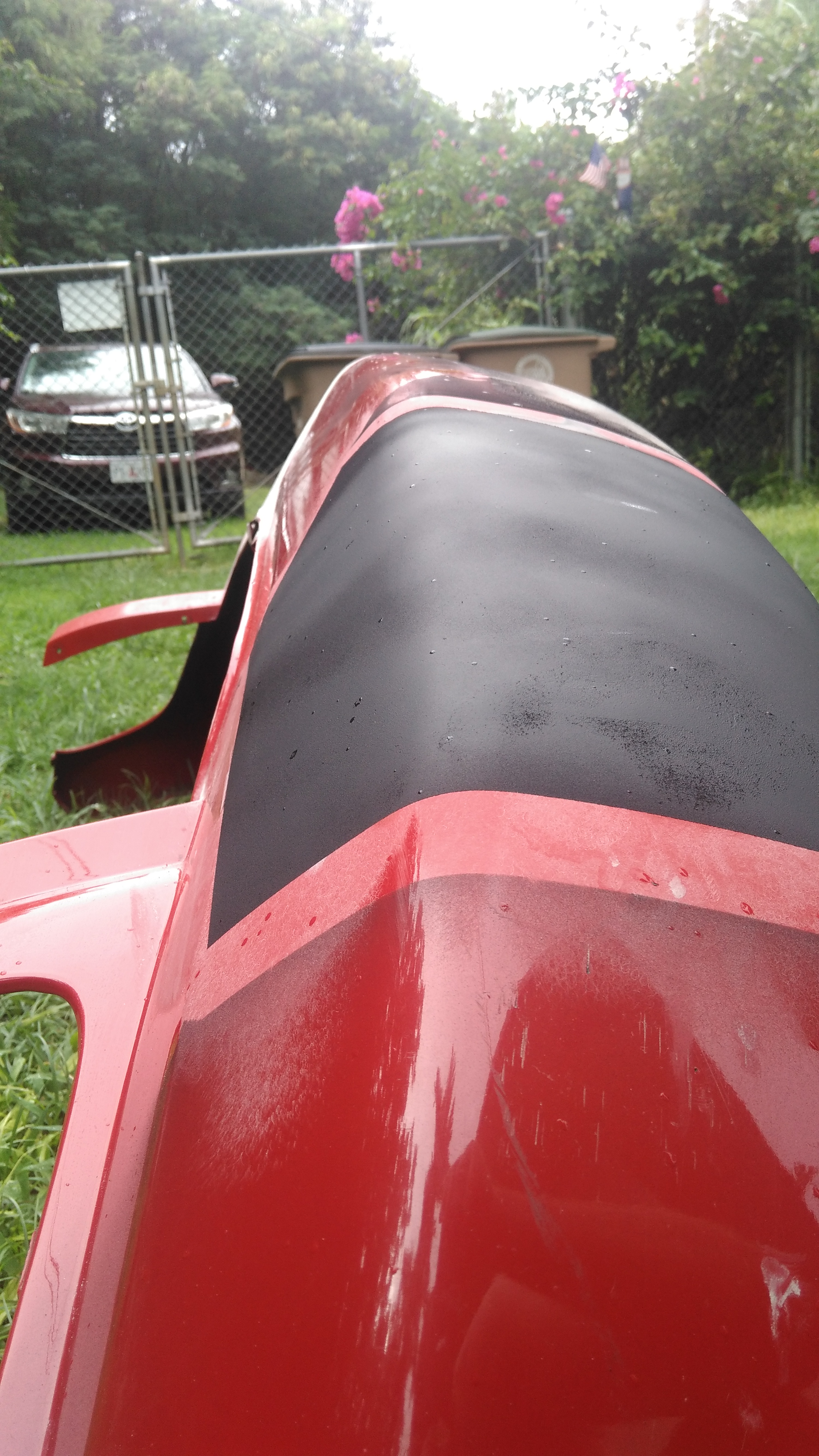

I know there's at least a few of you guys out there, either professional or who do it on the side. All you guys that do bodywork, great respect for you. I've kind of alluded to it before, but this work is hard. And everyone who does it, you guys rock. The patience and technique needed is huge.
So here's my body work for the day. I have the left side of the bumper good, I think. The bottom has a few pits, but all of the lines and contours are good enough for me, I think. I sprayed a coat of primer on, spray can, I know, so I could see what is going on and I'm happy.
But it's four in the afternoon, and I have some cleaning I've been neglecting since the wife is gone and a ten pound mahi-mahi to clean and bake. Here's some pictures. I moved the bumper out into the yard to get some more light. It's overcast and it started to sprinkle a little. And critiques are always welcome.

A little filler and detail sanding, it'll be ready for paint!

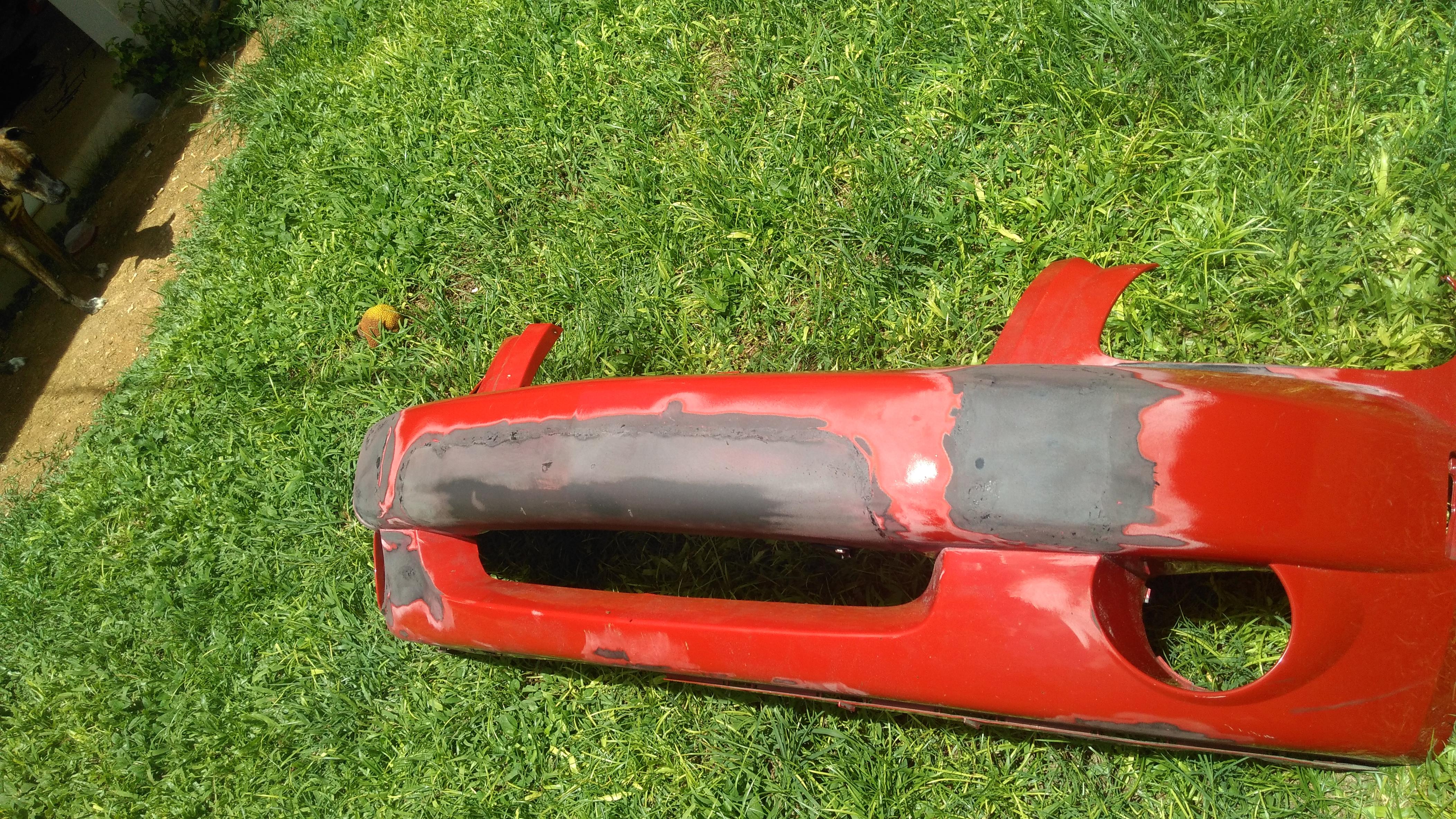

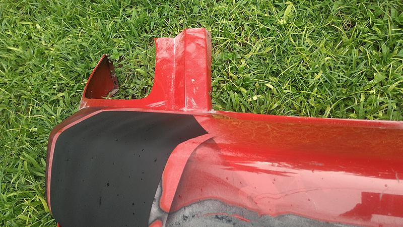

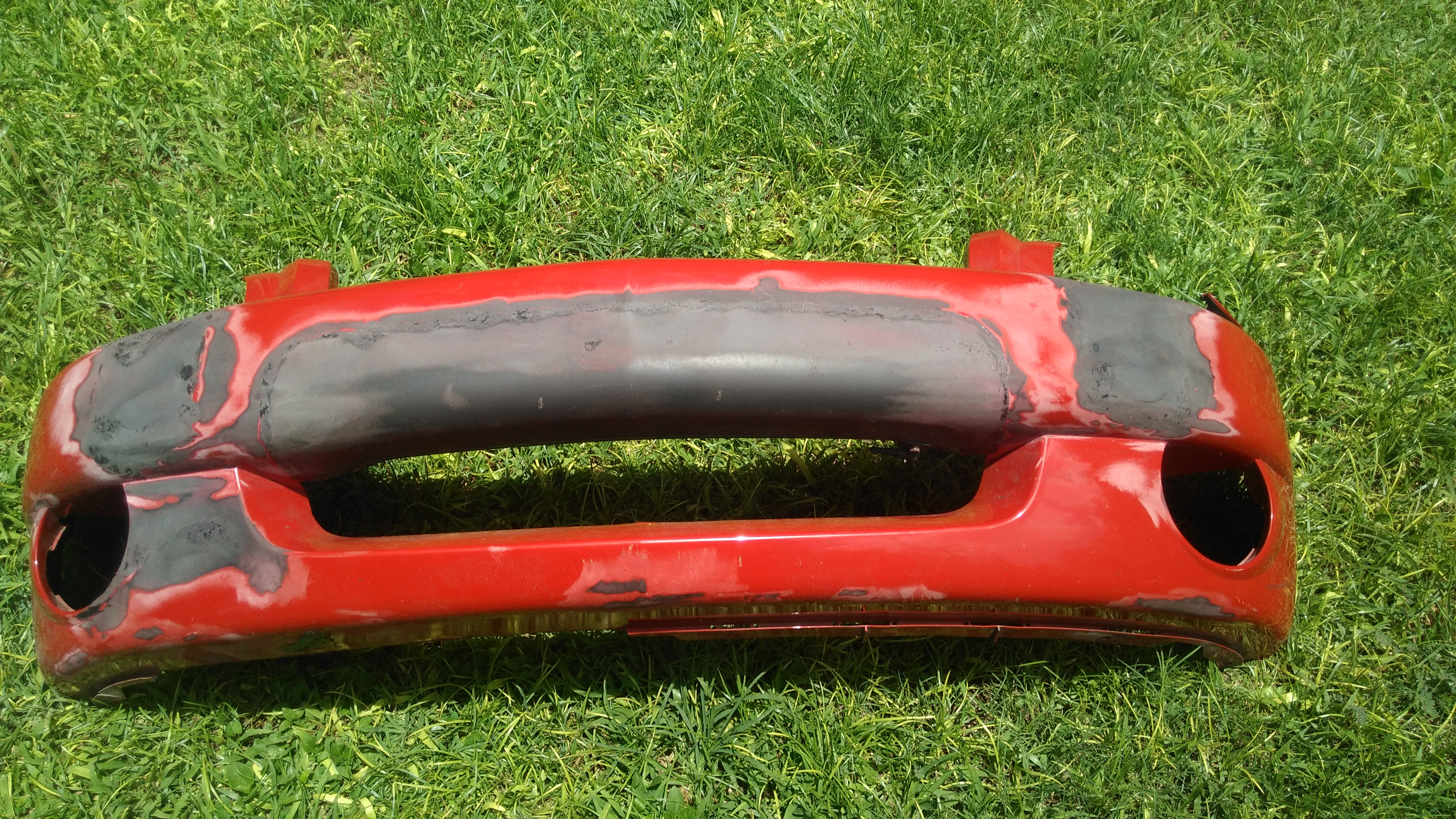

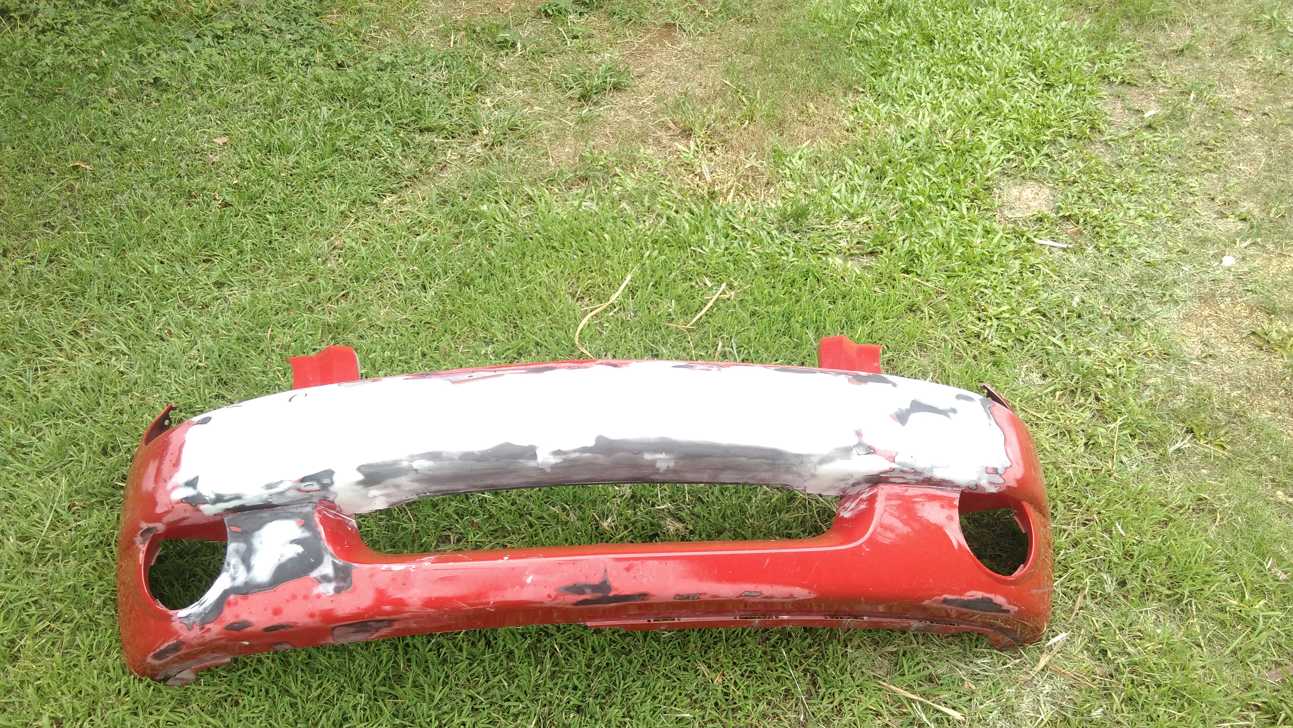

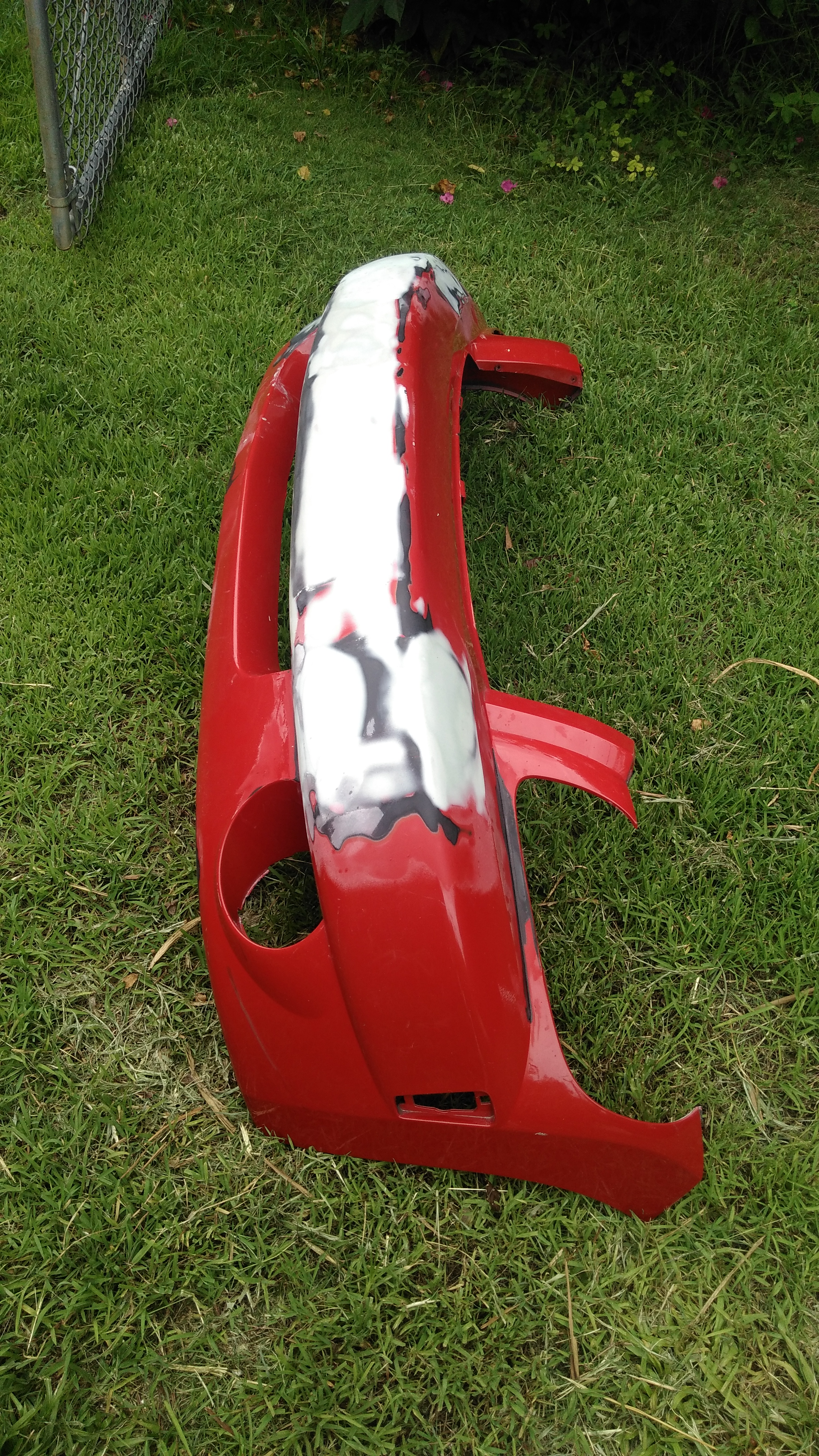

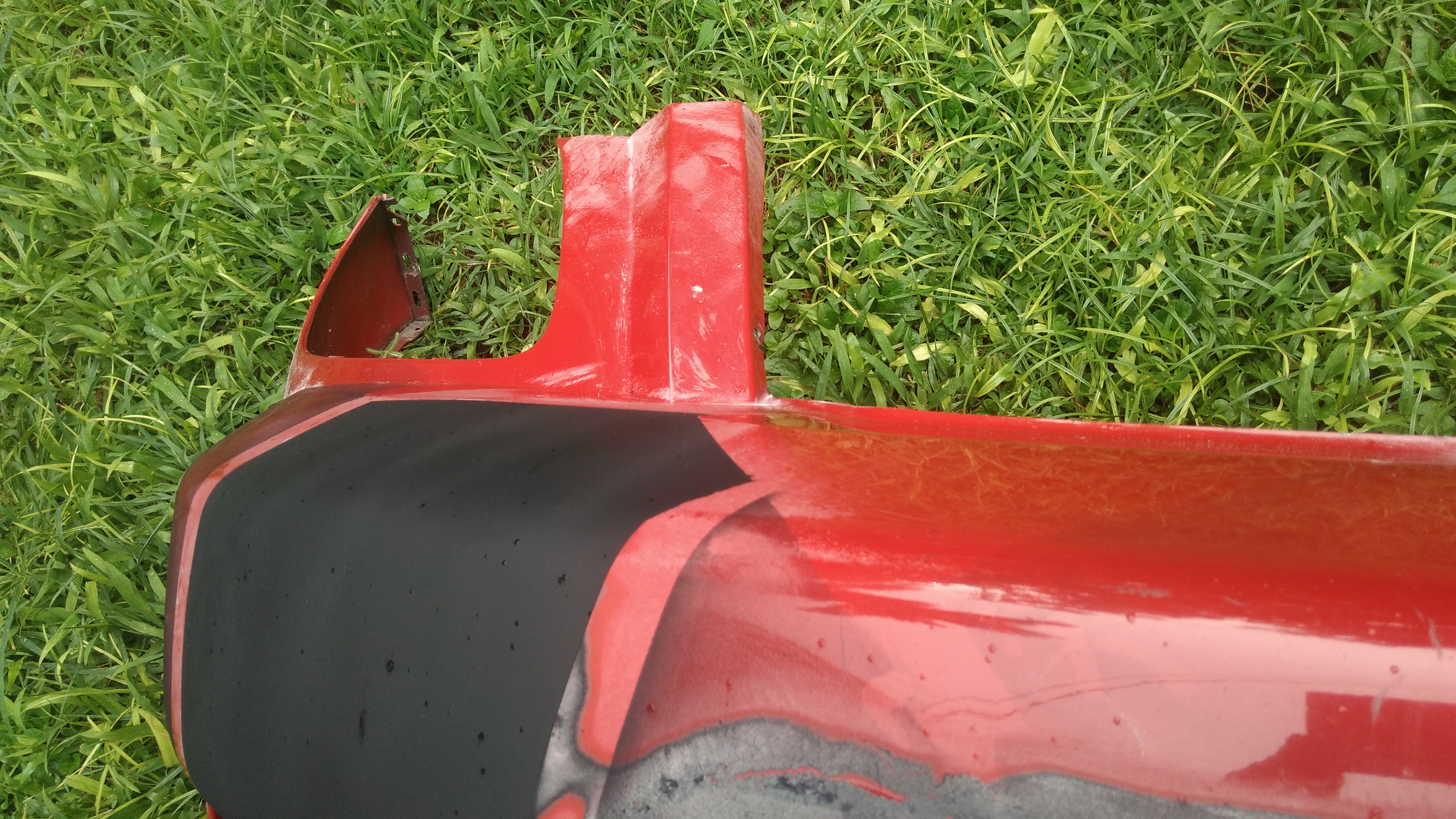

Front bumper work today
I finished all the filler work today, I think. The contours all came out nice, good enough for me. I definitely had my patience tested thru this. Sand, add filler, sand, add filler, sand some more, more filler, sand some more, and so on. I know that a lot of talk on the internet is that this type of filler is a no go on plastic, but I'm hopeful. The plastic welded in is strong and the welds and the donor bumper are actually thicker than the original.
I did have a few trouble spots. I had a crack that went into the passenger fog light. I did the best I could with the shaping. It's not perfect, but I'm satisfied with it. Also underneath the middle section on both sides. I'm using a Ryobi cordless sander, so it was all hand and block sanding in the corners.
I also don't have a solution for repairing the bottom of the bumper where the, front spoiler?, goes. I'm not super worried because I can secure the spoiler and you can't see where the bumper is broken.
Next weekend will be Prep for paint, and hopefully a few coats. I don't have a gun, so I will be using cans, I know, terrible idea. I also wasnt planning on painting the entire bumper, but I am now.
I have to go order more Rustoleum color match paint from Home Depot, and it might be here by the time I'm ready for spraying on the rear bumper.
Also, what are your guy's opinions for the type of clear coat? Acrylic is what I used on my tail lights. And here's the pics.

Clear coat has to be the same type of paint as the color coat...

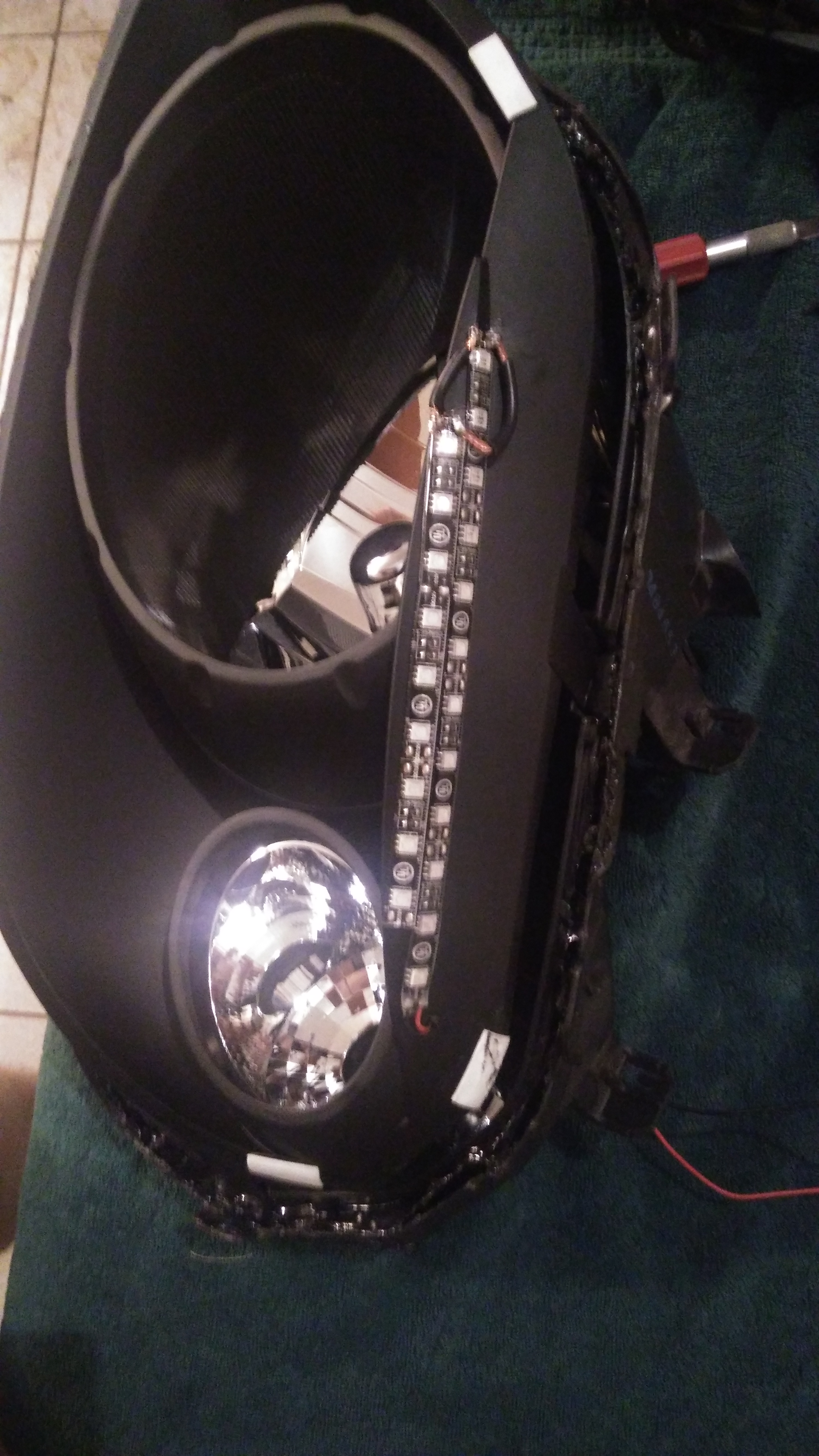

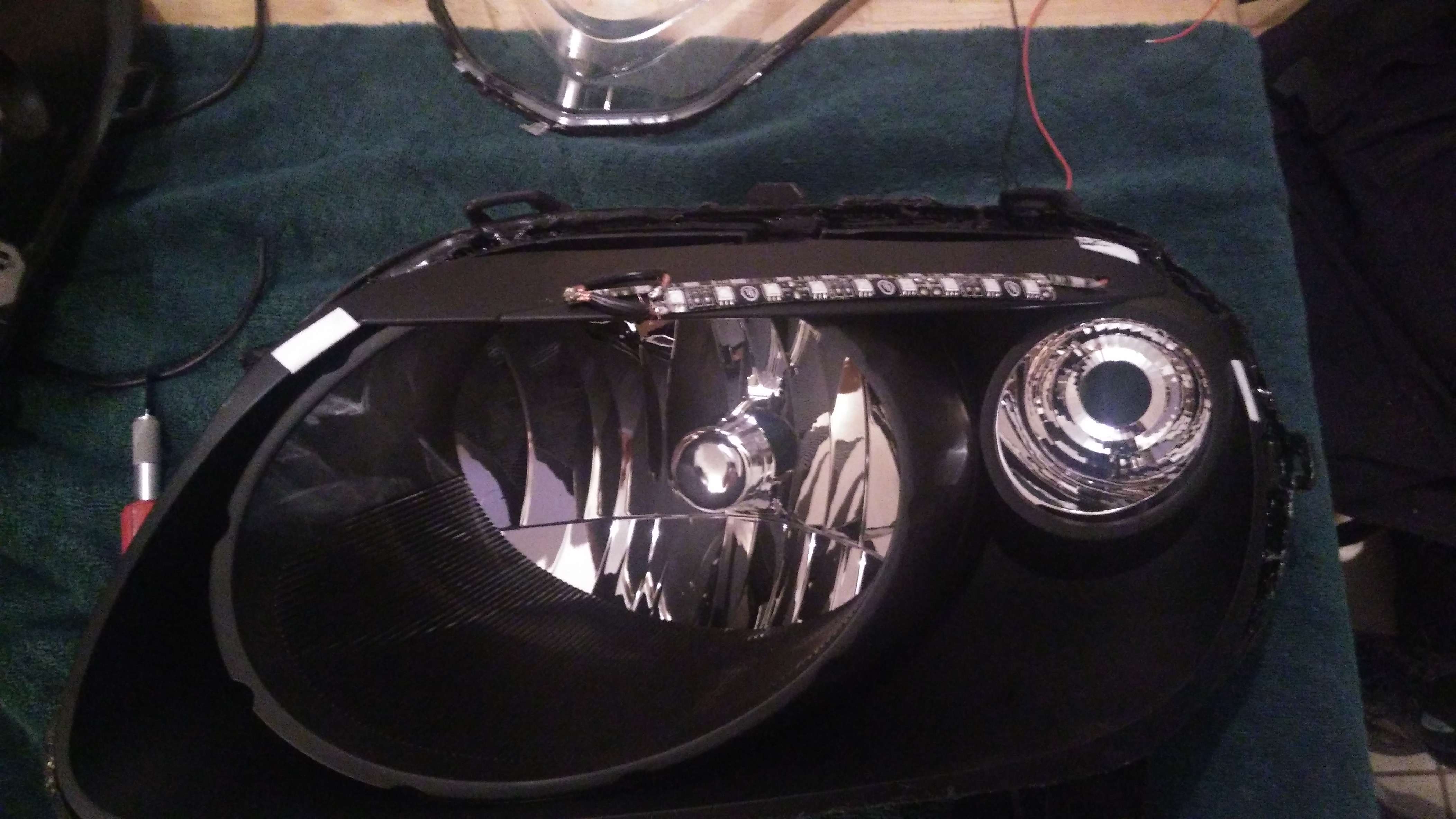

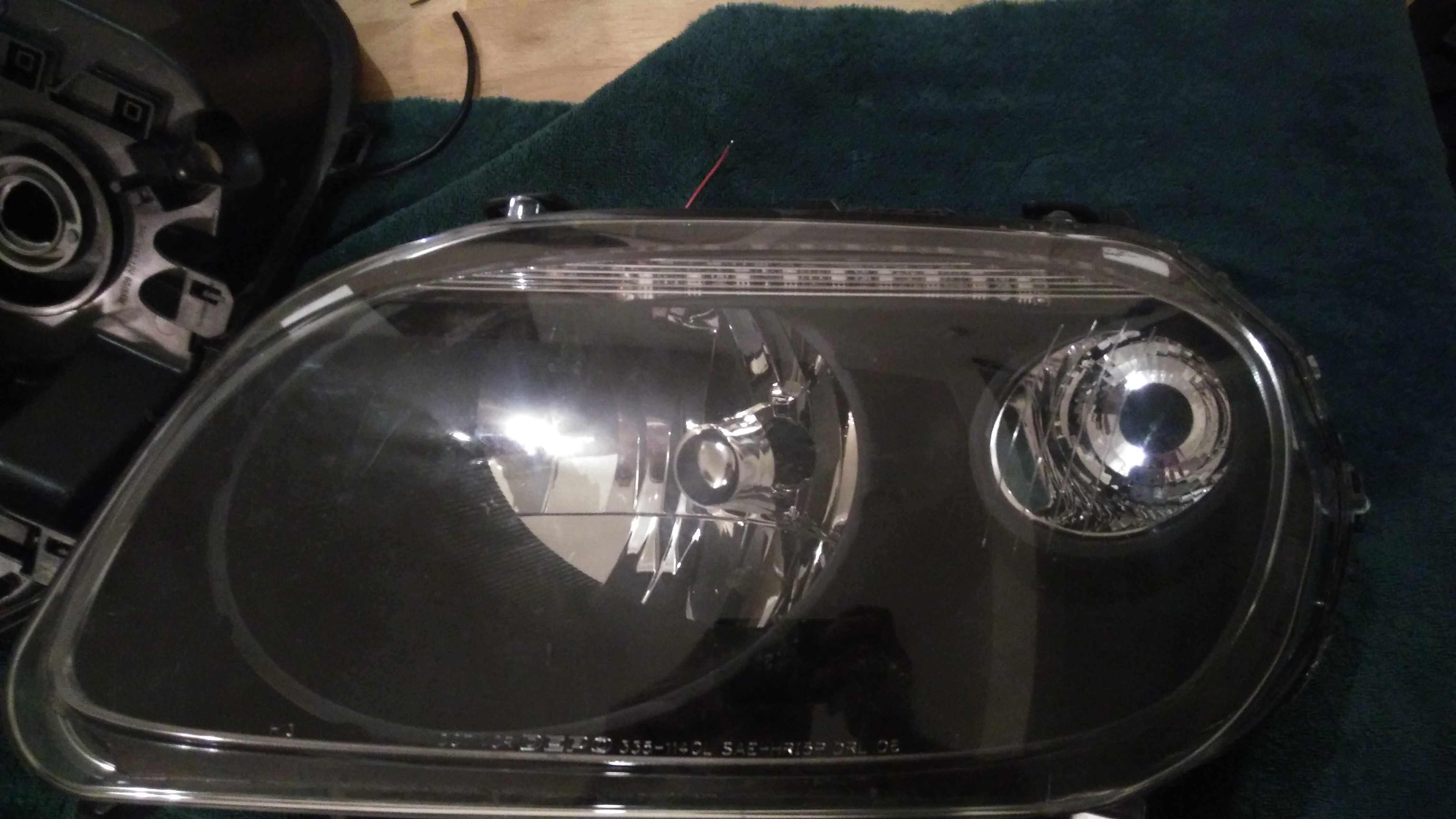

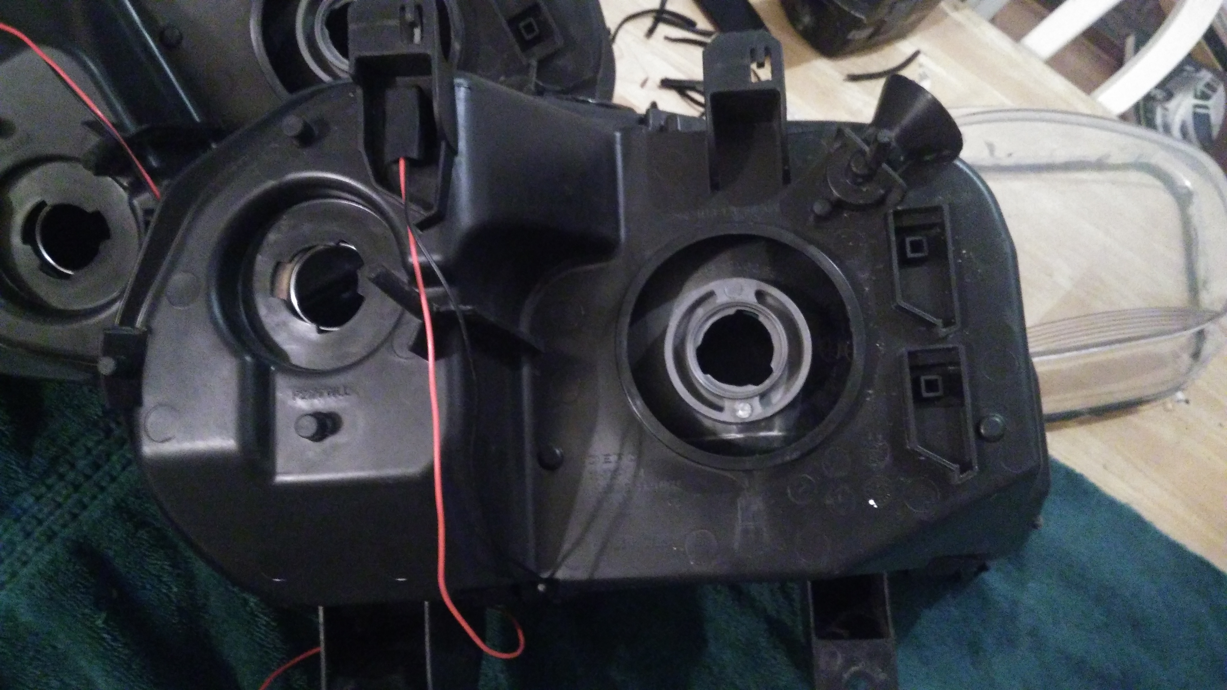

Head Lights
This evening I decided to get a started on another project even though my bumper is far from finished. So much for working one at a time until completion. I'll just say my lighting isn't really good to work in the carpport at night to rationalise to myself. I added two led strips to each headlight. I did two so that they match the light output of the fog lamps I added halos to. I don't think you'll be able to tell there's two with them off, they're behind the diffuser on the housing cover. Opening up the Depo lights was so much easier than the stock housings. And I must say my sautering skills are coming along as well.
I only drilled one hole in each to go to the rear of the housing. If you've opened yours up, you know that there's two lenses that are connected to The rear of the housing, a piece that covers the dead space around the lenses, and then the clear cover. The wires exit the housing through one of the existing vents.
The led strips will be wired to an auxiliary switch with the fog lamp halos. I am doing this because they are red, and even though Guam's driving laws are very lax, I would prefer to control the red independently of the driving or parking lights and not have them on while driving down the road, well mostly off when driving.
I know this has been done before, but I do like the look of it, even if it seems every new car out has led strips for driving lights, my wife's car included. What can I say, I like it.
They're not quite complete, I just want to spend some time cleaning the housings really well before sealing them back up. Time I don't have tonight as I get ready for work in the morning. Here's the pics!
