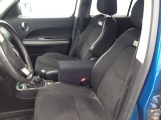

The one thing I couldn't get used to after I bought my SS, 5 speed was the lack of an armrest.
A cheap fix to this is outlined below. The project costs less than $10 and took only a few hours. Yes, you give up the front cupholders, but I can live with that. The armrest just flips back for easy access to the parking brake (or if you were planning on doing some competitive or "spirited" driving).

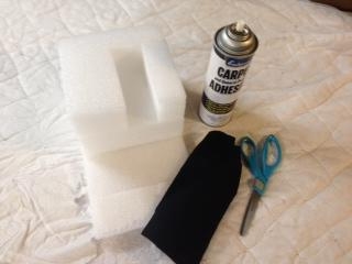

Materials: packing foam, spray adhesive, black cloth to upholster finished armrest:

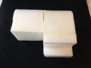

Glue together and laminate some blocks and sheets of packing foam using spray adhesive. Use the denser plastic packing foam that is used to pack computer monitors, TVs, etc., not styrofoam.

Bottom view, notch goes over parking brake handle:

One note, be aware of how tall the final product is. My box prototype was too high and made shifting uncomfortable. The final product is just right and doesn't interfere in any way.
Now I am ready for many long trips of comfortable driving.
