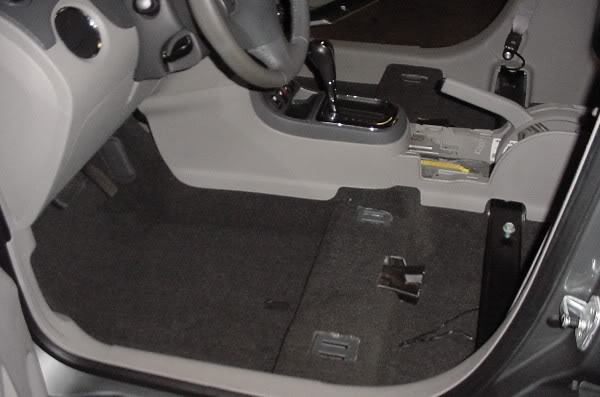

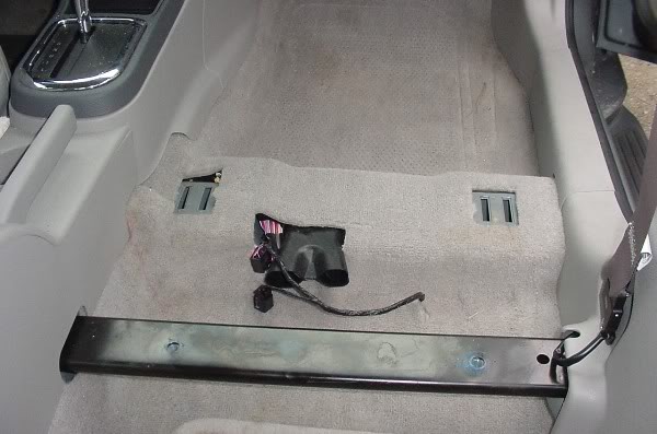

as far as fabricating a seat installation, I would have to say the delta platform does provide plenty of "room" to do so from what I encountered...in fact, that rear cross-bar set up is one of the coolest things I have encountered when gutting a car's interior...
as far as legal issues(SRS, seat belt locations, etc) and positioning of the seat, well...people will often forget about that when they modify a car anyway.
If i could change two things about my HHR, it would be the seat rake, and the steering column position-to-driver.

Many thanks for all the information! The pictures of the disassembly of the seat have given me an idea that maybe all I need is a lumber roll inserted behind the seat fabric.
