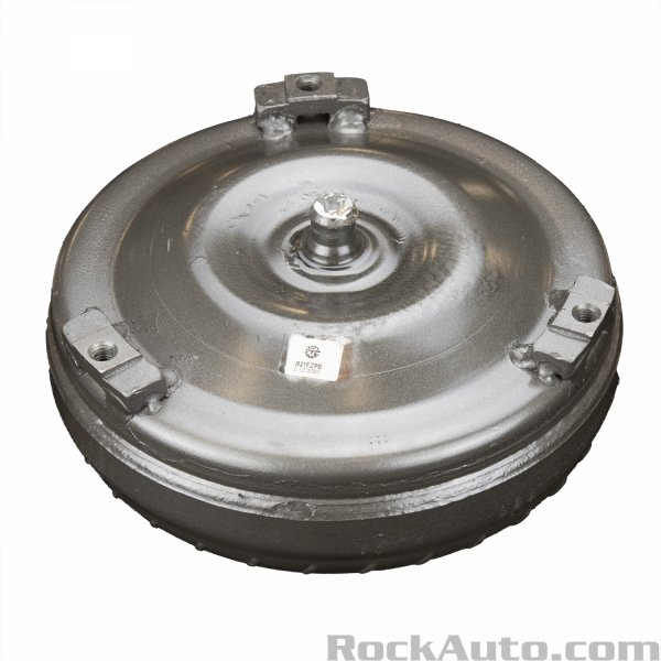

Torque converter bolts thread thru the flex plate, into metal nuts welded to the engine side, of the torque converter, so there can’t be aluminium on the threads , are you sure they aren’t from other bolts on the transmission or engine ? Perhaps photos to give us a clue.

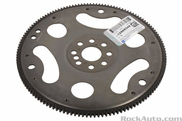

Actually, it looks like the bolts go through holes in the flexplate, and thread into the torque converter.
Old Aug 2, 2022 | 09:12 AM
  #35
Posts: 40,083
Yes, sorry, my bad, thru starter port, bolt goes thru flex plate into fastener welded to torque converter!
Old Aug 2, 2022 | 09:28 AM
  #36
RJ_RS_SS_350's Avatar
Joined: 05-01-2014
Posts: 8,512
From: California
Still, the female threads are steel, right, so there shouldn't be aluminum on the threads.. unless the bolt backed out completely, and was rattling around between the flexplate and the aluminum engine block.
Yes that is what happened
Old Aug 5, 2022 | 02:37 PM
  #39
Joined: 05-01-2014
Posts: 8,512
From: California
Ok, now we're getting somewhere, I was starting to think that you were trolling us.
So the torque converter is disconnected from the flexplate. You probably need to replace both the flexplate and the torque converter. The bolts being loose probably destroyed the threads on the torque converter. The bolts rattling around between the flexplate and the engine block probably damaged the flexplate. The welding on the flexplate wasn't good for it, either.
You've already pulled the engine once, so you obviously know how to separate the engine from the transmission. I don't think the transmission can be removed without also removing the engine.
So remove the engine again, like you did before, out the top. Or drop the engine and transmission out the bottom on the cradle, your choice.
I used fastsuv's how-to as a guide. https://www.chevyhhr.net/forums/how-...ut-lift-57722/
And here's my engine replacement thread. https://www.chevyhhr.net/forums/prob...-engine-62561/
