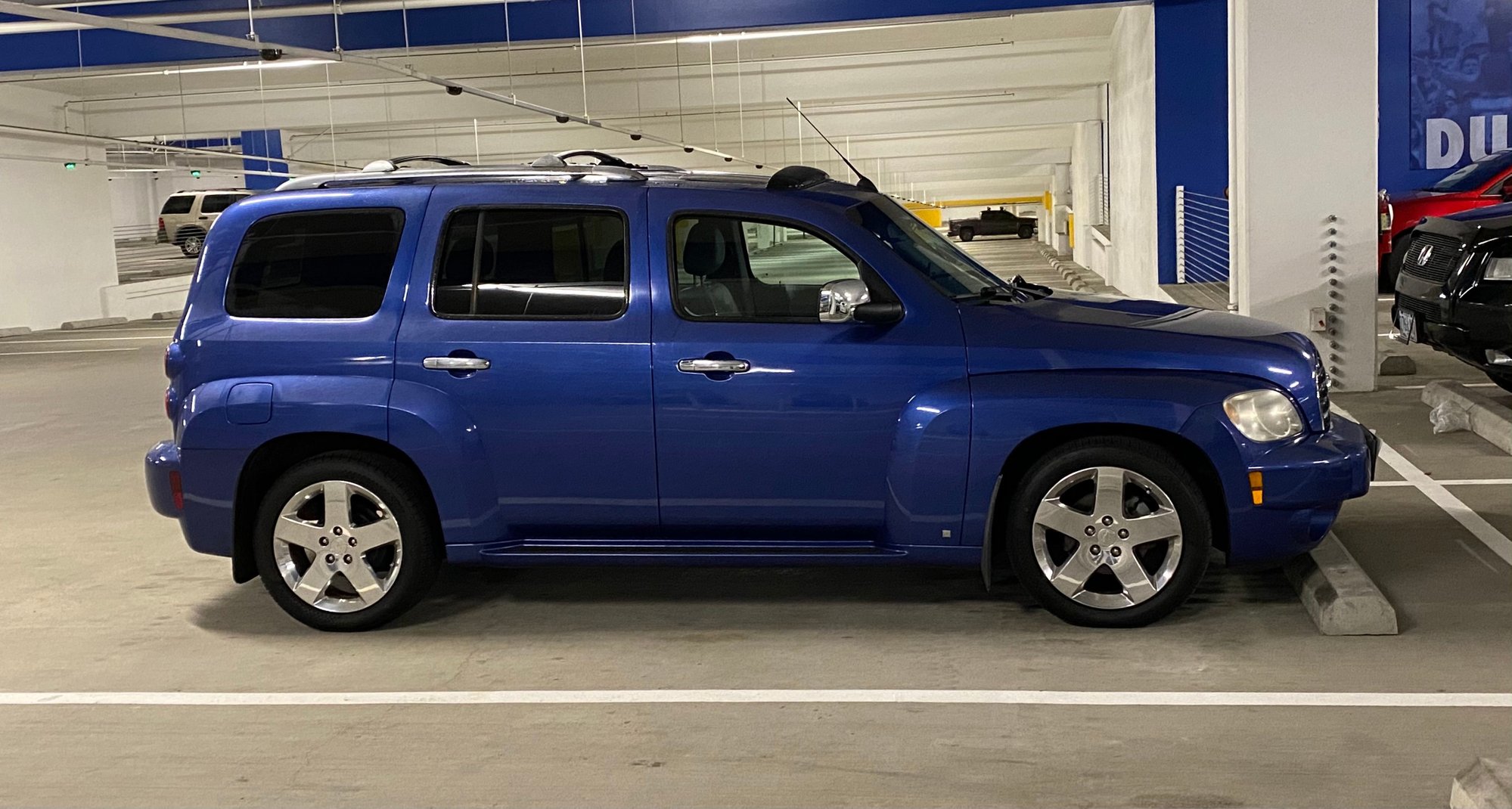

Here is the only pic I have of her. It’s does have the dreaded leaking water inside issue. But I’m not too worried about it.
Old Mar 1, 2021 | 05:40 PM
Posts: 26,532
Butyl patch under cowl.

The water leak is on the driver side
Old Mar 1, 2021 | 06:32 PM
Posts: 40,082
Water getting past the wire harness boot near the door hinges, make sure the rubber boot is seated properly and add a water trough like this
but then again, it could be the AC drain is clogged!
