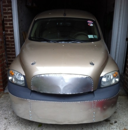

The attached photos include one shot of the front, where I replaced the stock bumper with an SS bumper and then sheathed the entire thing--and the grille--in riveted aluminum. This is actually a class rule. I'm planning to run the car in G/BGALT ("G" is the engine class--1.0 to 2.0 liters; "BGALT" stands for "blown gas altered"), and two of the requirements in the altered class are an engine swap (done) and having the front bumper, grille and headlights covered (done, except for the headlights, which will be covered when I dip the car).

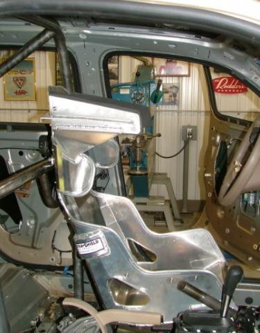

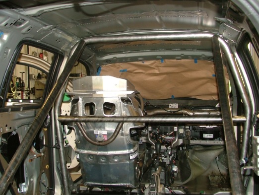

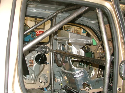

The other shots are of the cage build, which is currently being done by Joe Timney at Delaware Chassis Works (great guy, great company). In addition to the full cage, there's a full-containment seat (shown in the photos), and he'll be installing a fire-suppression system (two ten-pound bottles, one for the engine and one for the ****pit) and a parachute from Stroud. The car will also have five-point belts and a window net.
The mirrors, wipers and antenna are gone; the mirror holes will be replaced with fresh-air intakes. Roof rails (3/4" aluminum angles that run along the outer edges of the roof from the windshield back to the rear window, and are supposed to act like NASCAR roof flaps) are also required; I fabbed these up and will install them when I get the car back. I've also added the required hood pins. The interior, as you can see, is stripped; all of the door locks are now inoperative, and I'll also be getting rid of the steering-wheel lock. Once the cage is in, I'll probably sheath the old dash with aluminum (like the bumper) and reinstall it, and also cover the door interiors with aluminum. I've got a pair of Aeroforce Interceptor gauges to show mph, rpm and boost; these connect to the OBD port and will probably be mounted somewhere on the cage.

Nice choice of racing seat, and good cage fabrication, you hope you never need 'em. But it's well thought out and neatly done.
