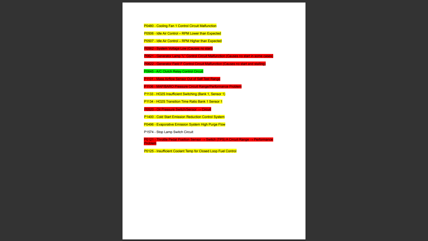

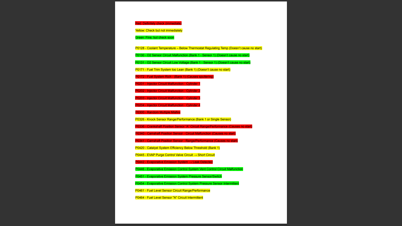

So him and I started to look into the issue. We switched out the ignition coil and the module on top of it, the ignition switch, and put in a new battery. A few days ago I got a code reader that works for my car, and a bunch of codes popped up (I wrote them all down into a word document that's attached to the post. We changed out the crankshaft position sensor, and I checked the injector fuse because all 4 injectors going bad at the same time is very rare from what I hear. The car cranks, but it doesn't turn over and start, and the injector fuse isn't blown. I can also hear the fuel pump in the back making a little humming noise that indicates that it's working. I did take out two of the spark plugs and noticed that the diodes are brown on it, so I'm going to replace those when I can get to autozone and get new ones. We also sprayed starter fluid on the throttle body, but that didn't help either. I haven't done too much looking into the throttle body (because I am not sure how to diagnose it, I'm really new to learning about cars), but it might be too dirty and I might need to replace it. I'm not really sure what else I can check in terms of what is causing my car to crank but not start. Any help would be greatly appreciated :)

What does the color coding mean?
Old Feb 16, 2023 | 05:38 PM
Posts: 26,532
I can't read the document or the wall of letters.
Old Feb 16, 2023 | 06:54 PM
Posts: 11,721
The top of the code chart tells you what the colors stand for.

I zoomed in, it is a bit blurry. But the red really hurts the eyes. I was able to make it out, through the pain.
How was it decided which codes were more important? Are these codes current, pending, historical?
Don't worry about the priority according to color as the EVAP code is RED and it's a low priority code.

P0016 or p0017, timing chain codes, aren't in the list. But the list is worthless without knowing the status of each code, so we'll have to wait for that information.
